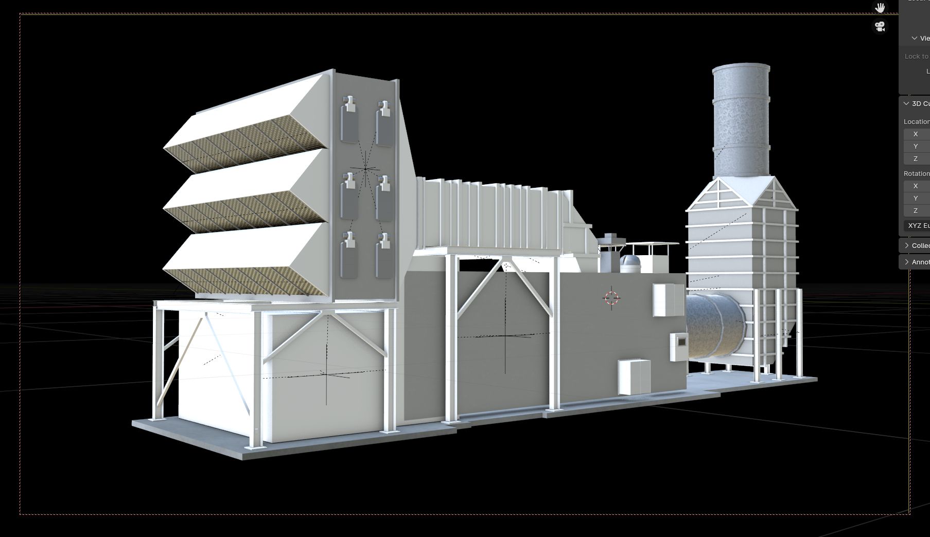

    I only have one camera in my scene, there are no puzzles yet.

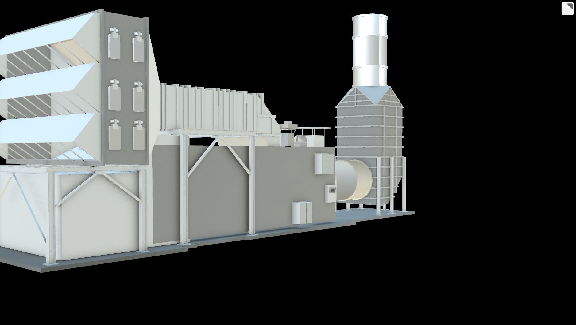

    When I load the scene in Verge3D the view has changed, it appears the camera coordinates have been transformed somehow… what can account for this difference?
    In Blender:
    https://www.soft8soft.com/wp-content/uploads/2025/01/blenderCameraView.jpg
    In the Browser:
    https://www.soft8soft.com/wp-content/uploads/2025/01/verge3DCameraView.jpg
    Thanks.

    This is a common problem that is commonly solved by adding an empty to the cameras location in blender – call it Cam_Loc. Then add an empty to where you wan the camera to point to …call it Cam_Tar. Then in V3D you should use the “set active camera” puzzle to your camera. Then you can use the object “snap” puzzle and snap the camera to Cam_Loc and then use the Camera Look at puzzle to Cam_Tar and set time to 0. This will ensure you camera in Blender and V3D are the same.

    Thanks, it’s weird that the scene camera coords are changed in V3D, why do you suppose it does that?
    Apparently V3D makes the scene camera point to global 0,0,0 or maybe it points to the 3D cursor when loaded? Adding an empty seems like an odd extra step.
    I simply moved the geometry of my model to 0,0,0 which did the trick.
    #79827
    Please see this page for methods to set the orbiting point of the camera.
