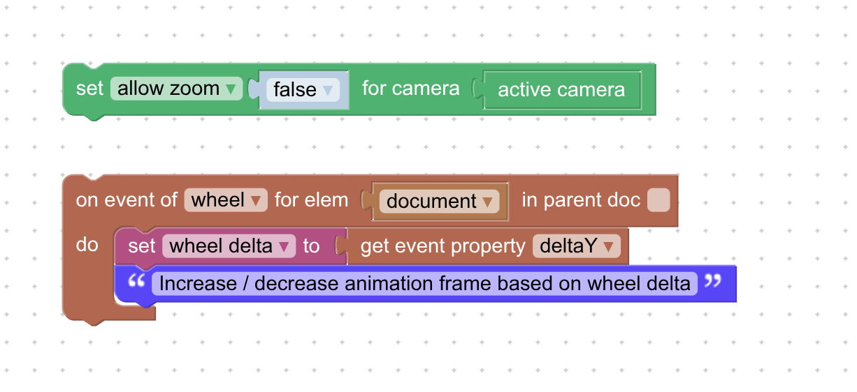

Working with 3D Max 2022 and Verge 4.8.0
i´m working on a project where i need to move a camera along a path.
This works fine….of courseBut i need to move it by using the scrolling wheel on the mouse….forewards and backwards
cant find any puzzles to do that…..
Any hints?Thanks in advance
Ger
2025-09-04 at 9:36 am #84435
Alexander KovelenovStaffHi Ger,
This is quite easy to implement actually. You just make regular camera animation and control it’s frame based on the scroll delta (you obtain it using the “wheel” event). See a basic example attached:

2025-09-04 at 10:04 am #84444gf3d
CustomerThanks Alexander…….so far so clear…..but i cannot find this “Set to” puzzle
Greets
Ger

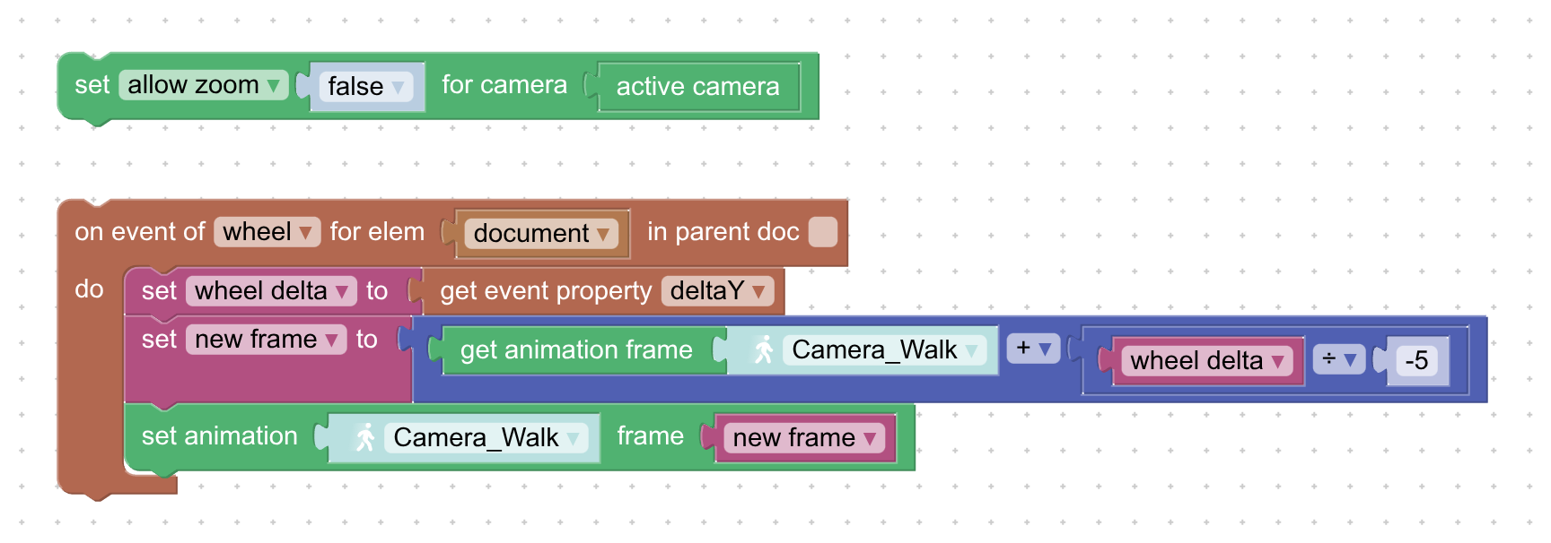

2025-09-08 at 6:51 am #84504
Here is the short puzzle snippet that moves the camera forwards/backwards:
Hope it helps!

2025-09-08 at 8:18 am #84508
Alexander KovelenovStaffYep, I’ve applied the scenario above to your scene and it worked for me. Could you give it another shot?
