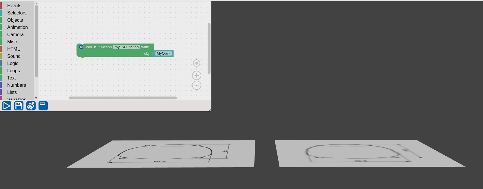

    Code can be added to a project with the following steps:
    1. Register a function in your app .js file and put your code there, e.g.
    function prepareExternalInterface(app) {
        app.ExternalInterface.myJSFunction = function(objName) {
            app.scene.traverse(function(obj) {
                if (objName == obj.name) {
                    obj.material.map.anisotropy = app.renderer.capabilities.getMaxAnisotropy();
                    obj.material.map.needsUpdate = true;
    2. Call this function from Puzzles (see screenshot)
    I made a working example (it’s Blender-based but the code should work for Max too).
