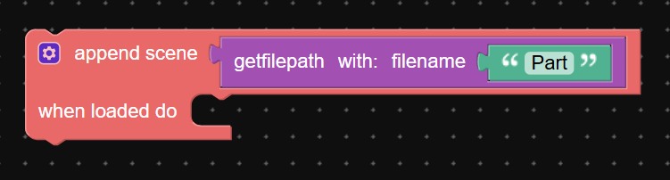

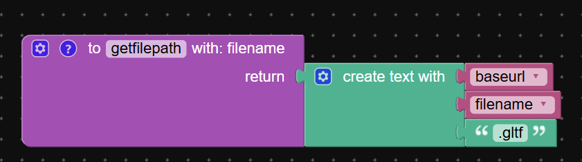

    Hello all,
    In the configurator i’am building I use a procedure (see screenshot) to set the base url our website builder can set. This method is usable for all files in the project except: basis_transcoder.js and basis_transcoder.wasm. Is there a way the path to these two files can be set in puzzles?
    Thanks in advance!
    #78349
    Hi martenmonoz,
    These two files are used to load compressed textures and loaded automatically by v3d.js. Make sure they are placed in the same directory as v3d.js. There is no way to change the path in Puzzles since Puzzles are initialized after the engine is loaded. In code it can be changed like this:
    app.loader.ktx2Loader.setTranscoderPath('new_path')
    #78352
    martenmonoz
    Thank you Yuri! If compressed textures is ticked off in my case in blender and the initialize puzzle load compressed textures is ticked off in verge, both files wont be necessary?
    #78387
    yep! you can just turn it off
    #78391
    martenmonoz
    Thanks!!
