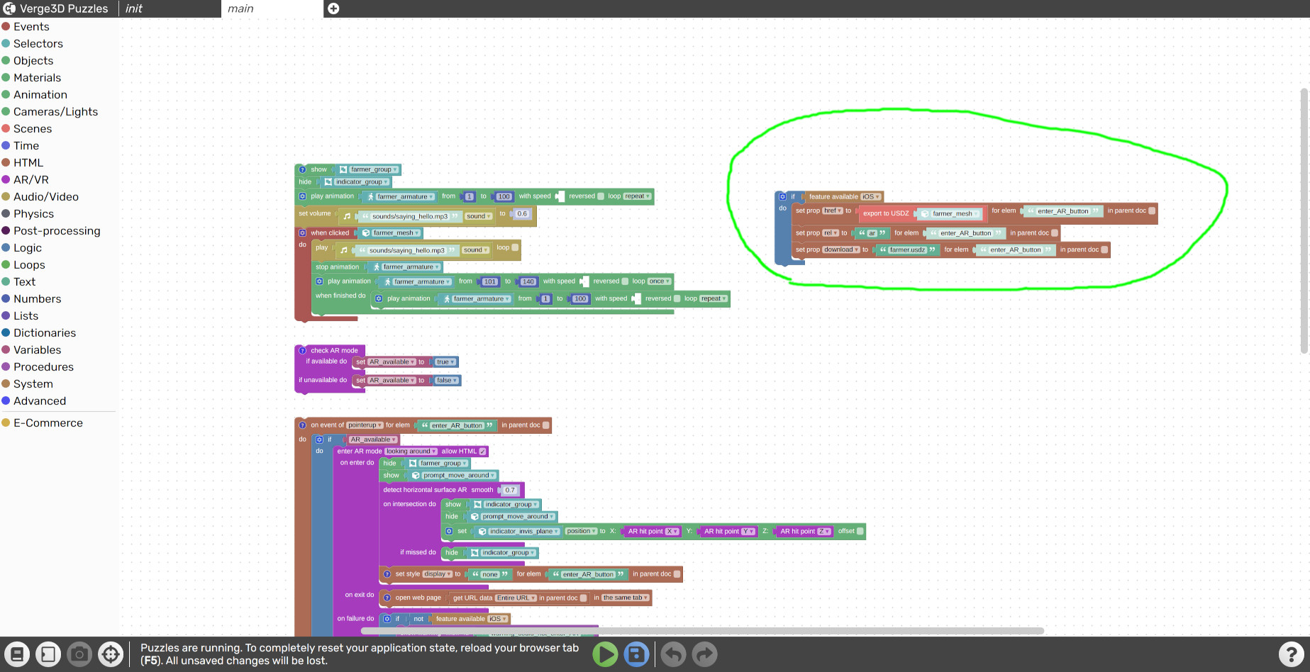

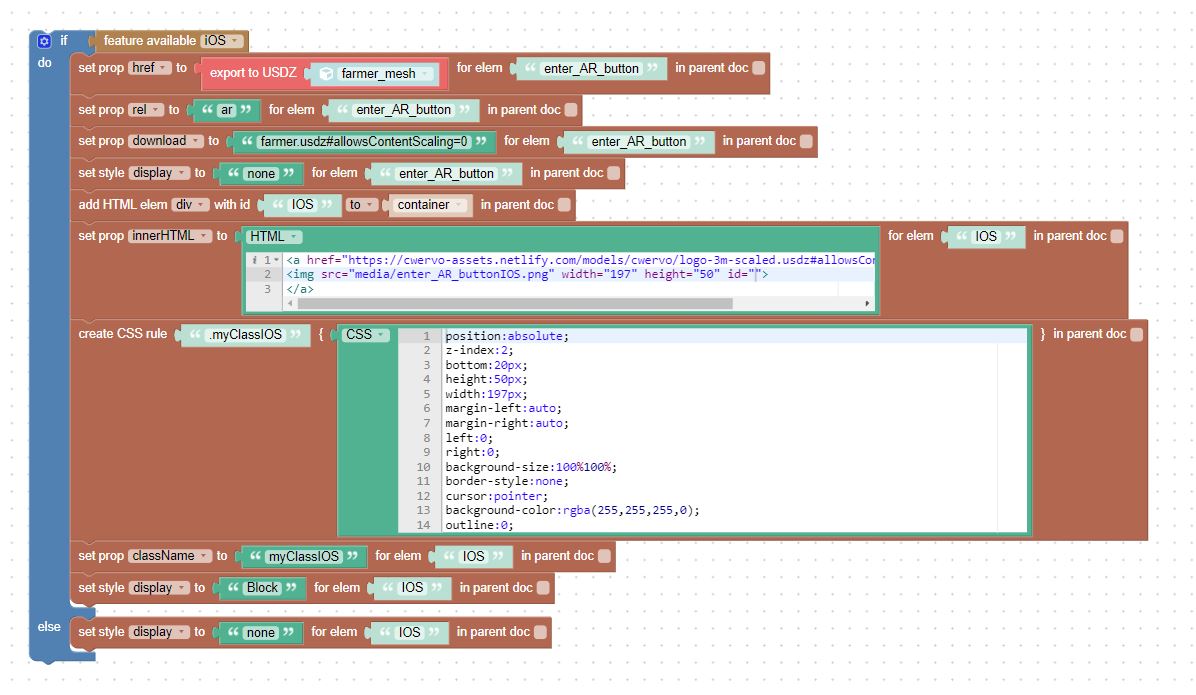

    Hi Yuri & Alex,
    I’ve been looking into this scaling problem,…..
    got ‘something’ working :yahoo: :
    https://cdn.soft8soft.com/AROAJSY2GOEHMOFUVPIOE:95a3606e33/applications/augmented_reality/augmented_reality.html
    The Image Tag Is Required!!!!
    Could U guys, take a look(see Attachments) how to replace the “logo-3m-scaled.usdz#allowsContentScaling=0” for the “export to usdz” part,…
    any help is much appreciated!!!!
    Greetz Chris
