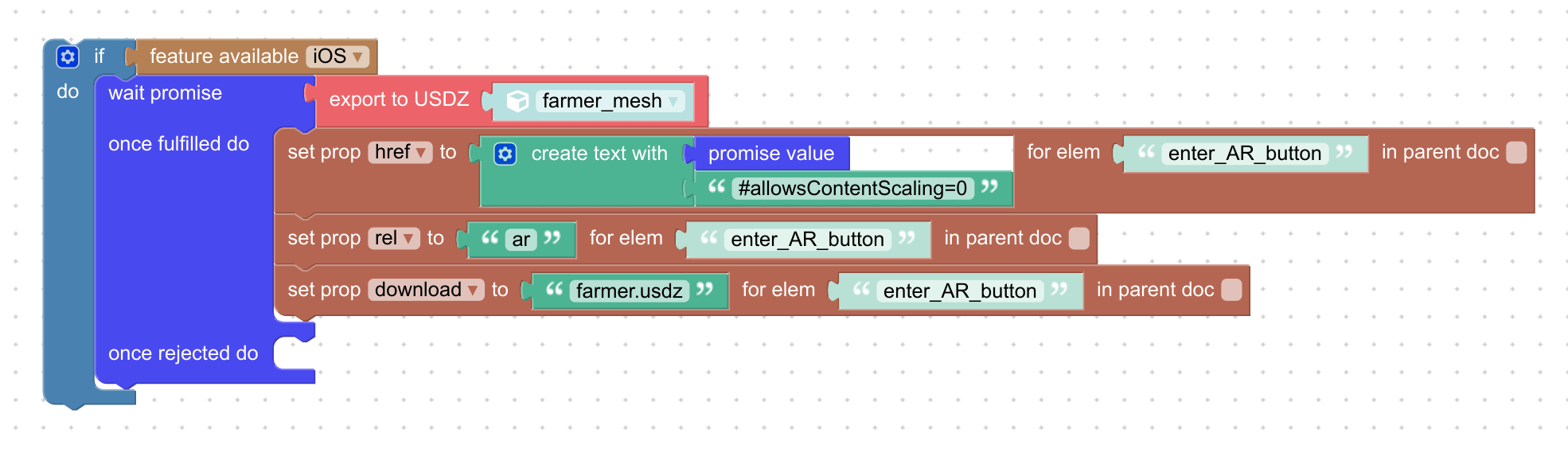

2021-09-15 at 6:30 am #44666
Yuri KovelenovStaff2021-09-15 at 9:04 am #44671

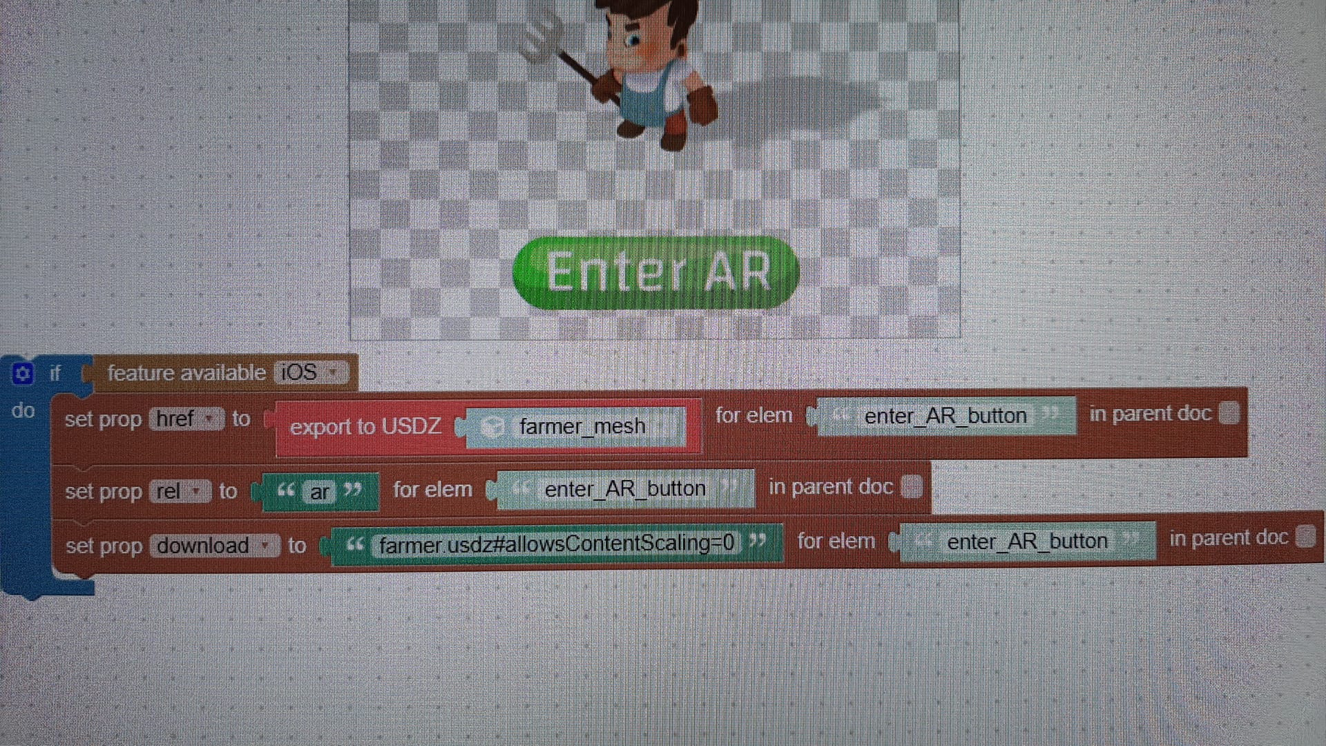

sirhcCustomerHu Yuri,
checked ur sugestion.
Doesn’t work
see attachmentsAttachments:
Technical Artwork Specialist@TBL.nl

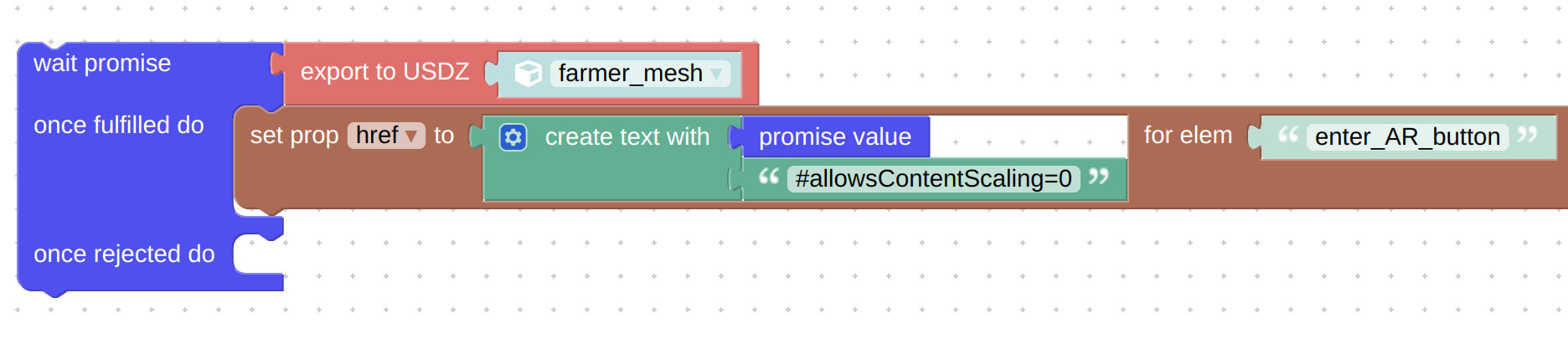

2021-09-15 at 10:22 am #44678
Yuri KovelenovStafflooks like it’s a bit more complicated – see attaches.
But unfortunately this won’t work either – there is a bug in Safari that prevents adding parameters to blobs.
So the only way for now is to create .usdz files manually and deploy them with your app (if you want to add parameters). You can use the same export to USDZ puzzle for making these files.
