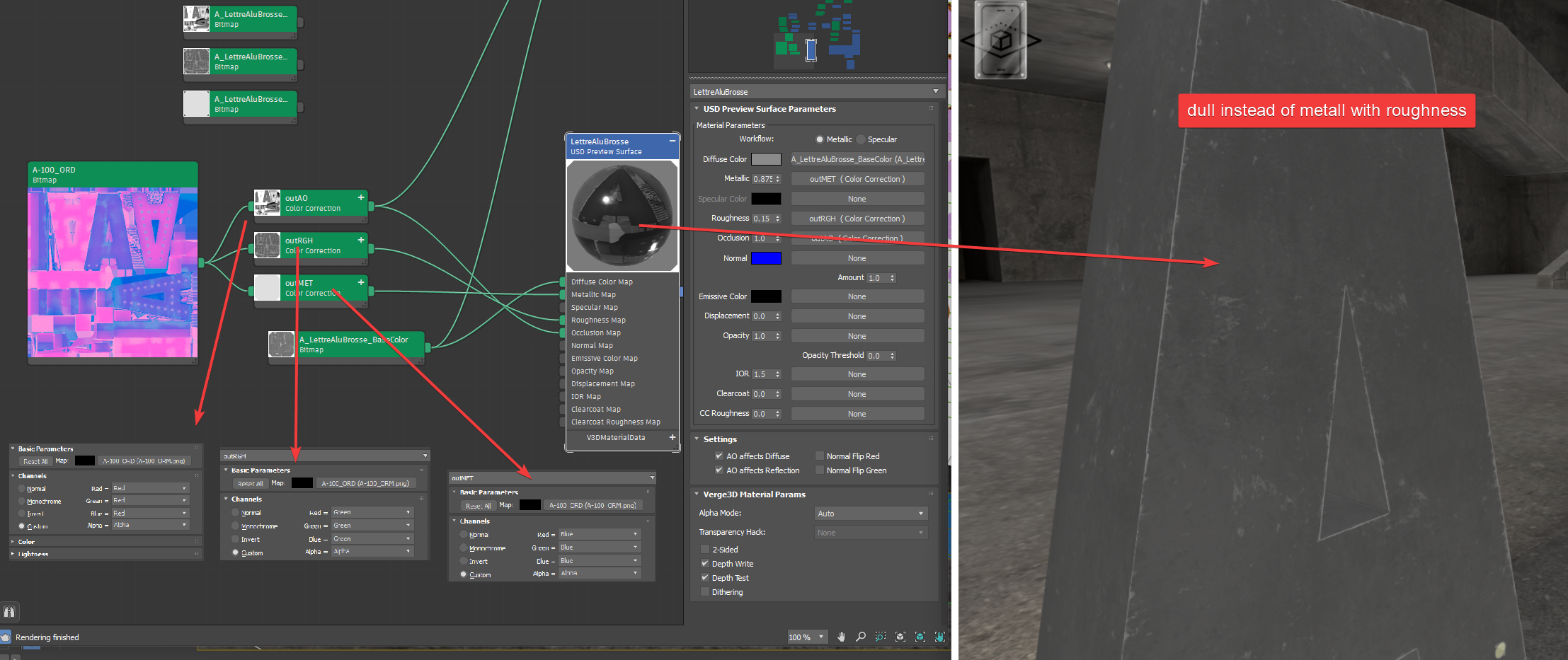

    Is there anyway to prevent the OcclusionRoughnessMetallic map auto generation ?
    I have made one myself with photoshop, and i use a “colorCorrection” to split this bitmap in Occlusion / roughness / metallic, like explained in the manual (red/red/red/alpha, g/g/g/a and b/b/b/a), but when i export the render is not good : roughness is dull, like if it was full white.
    So i tried to put grey-8b bitmaps separatelly, but then verge3D exporter creates a ORM map, looking exactly like the one i made myself but with a fancy name (occlusion_roughness_metallic_60985a40610fab44.png)…
    So question is : how to :
    – or prevent generation of this map and use my grey-8b bitmaps ?
    – or generate this ORM bitmap but with a choosen name ?
    – use my own ORM bitmap with roughness working ?
    See screenshots…

    USD (usdPreviewSurface) materials from 3ds Max are kinda special since they are converted to glTF 2.0-conformant PBR model upon exporting to Verge3D. This is intentional to keep greater level of compatibility between exported assets. The downside of this is that you can’t really use the conventional material system of 3ds Max. For more advanced texture control and a complete lookdev workflow, switch to Physical or OpenPBR materials.
