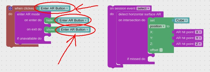

    I was just exploring the basic AR setting with puzzles.
    I found this image. May be a old reference but I am wondering,
    if the “enter AR button” is created with CSS rule & not from 3d object in scene how come that can be selected for “when clicked” button?
    How do we select that to run further or is there anything upgraded & I am missing on?

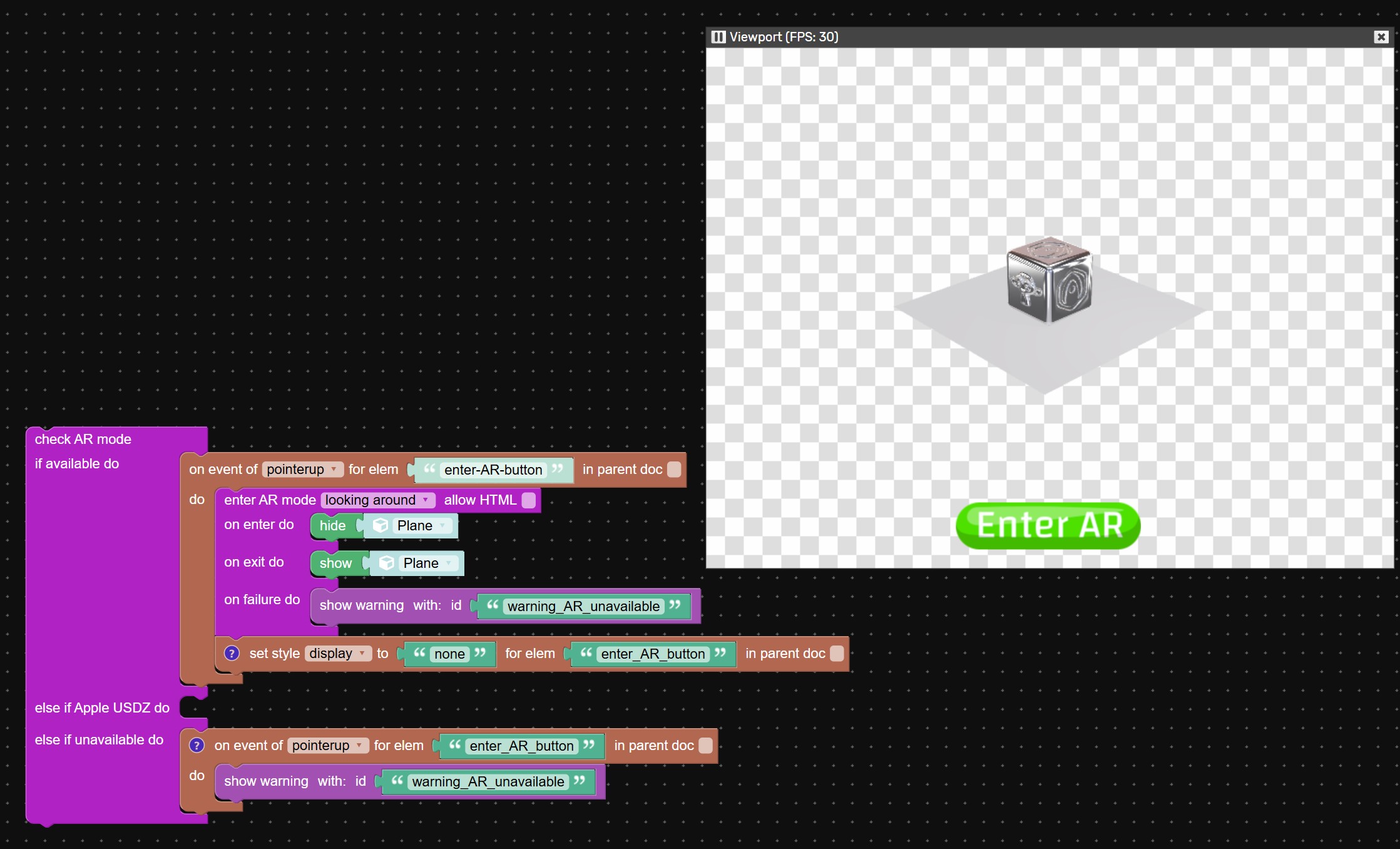

    visualizer
    Just to add..
    I could manage to on the clicking b y using “on event of “pointerup” and then choosing “enter-AR-button”
    Hope this is correct.
    But now there is a second issue, its not entering in AR mode & background also not showing transparent. in puzzle editor it shows correct transparent.
