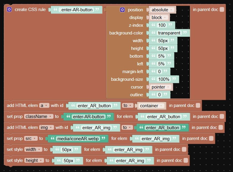

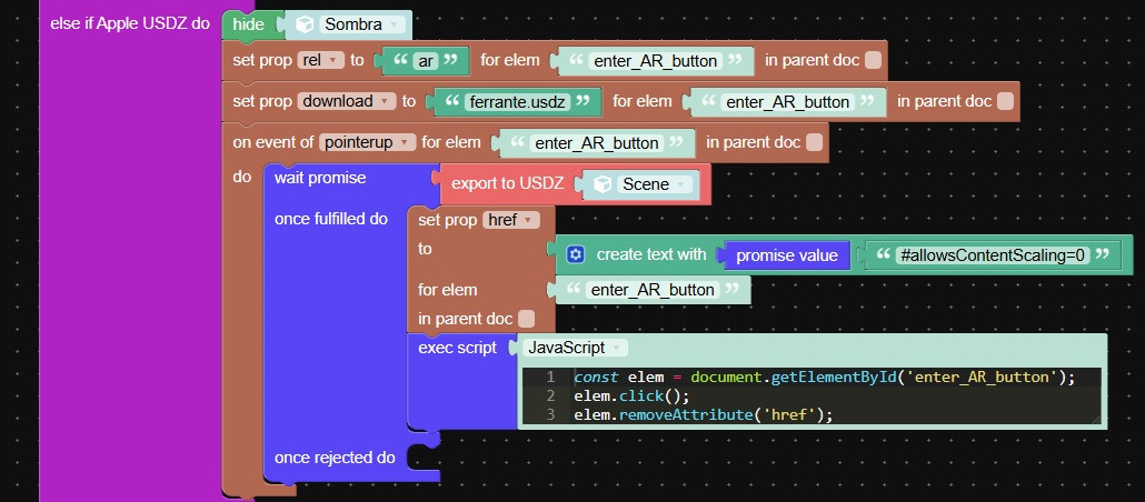

    Here are the puzzles I used to create the ar button as well, in case that helps:
