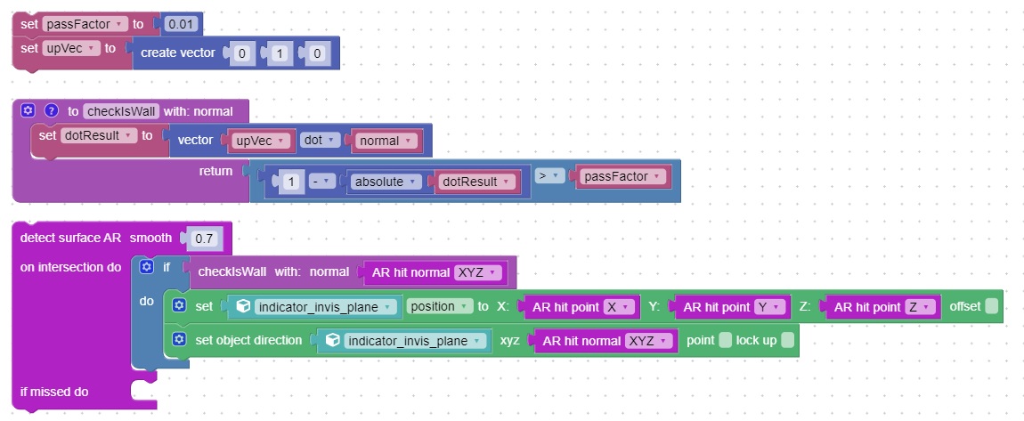

    I would like to know how can I detect object to the wall?
    I have the project that I want AR object not to the floor but to the wall instead
    Please advice the puzzle that I can use for this
    #58821
    Hi!
    The AR hit normal puzzle allows you to cast AR content not only to the floor but also to the ceiling and walls. For example, usually, if the AR hit normal is not collinear with the global up vector, then it is neither floor nor ceiling.

    That is fantastic, I will try to follow your puzzle

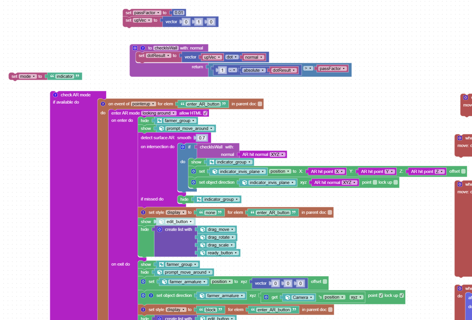

    Hi, I tried to implement the AR example of the farmer with the puzzle, but the AR doesn’t detect vertical planes.

    It should work, perhaps some issue with your device or environment causing incorrect placement. If you just place your object on a wall without setting its direction will it work? Alternatively, run the Augmented Reality demo (http://v3d.net/ar) and try move the cursor along the walls to see if it detects them properly.
