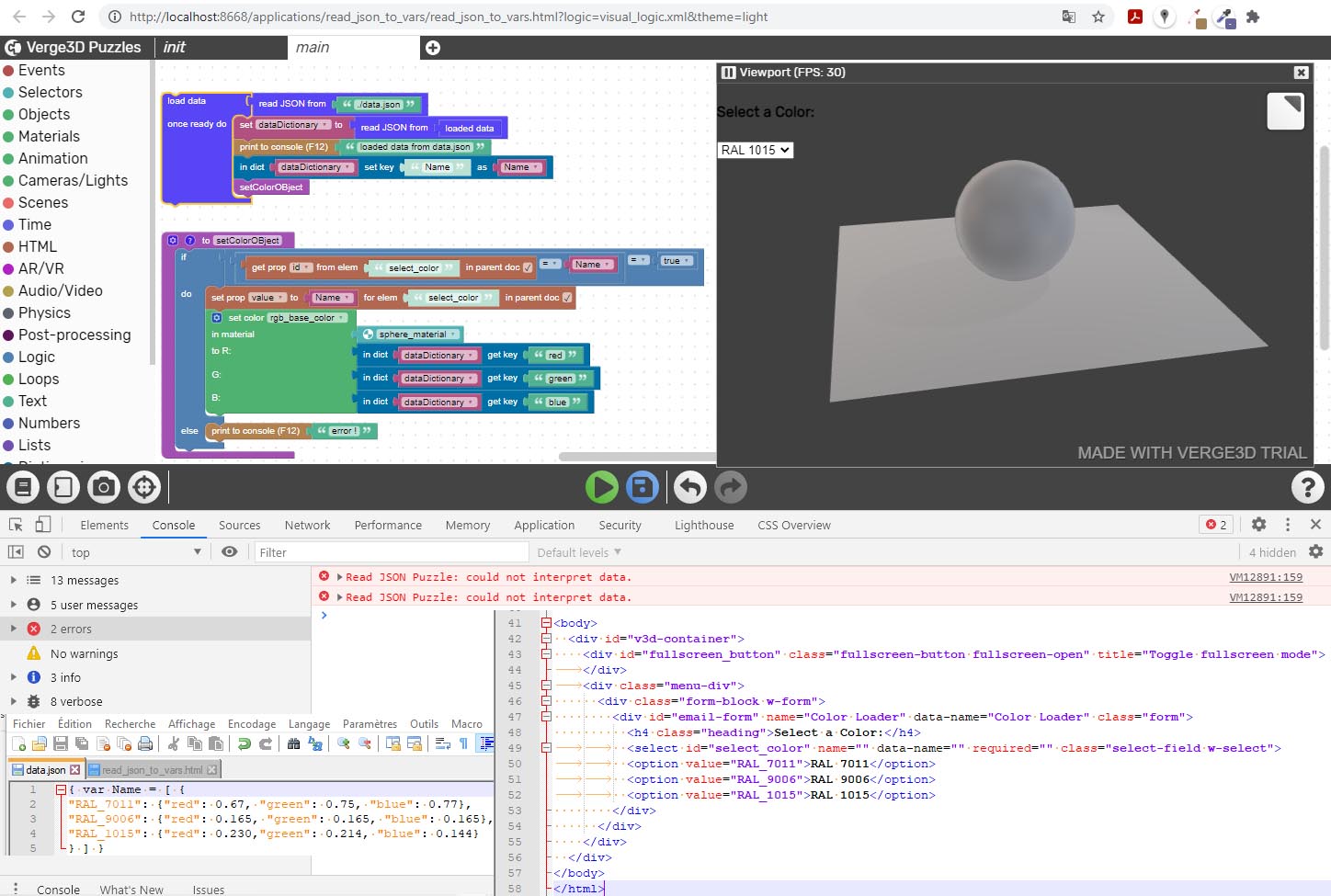

    I tried this tool and it’s magic !
    I’m webmaster and I have skills in html + css + (less in javascript)
    and 3D (modeling, mapping)
    nevertheless I need to programm with json in Verge3D.
    Even if there are some puzzles for json I don’t find what I want (for example how to parse json (with differents levels) from dropdown menu, etc…).
    I’m not a seasoned programmer and each time I need to view source code
    to understand programming I’m getting this message :”
    Developer Kit is intended for seasoned programmers who wish to modify the engine. You don’t need it for creating Verge3D applications with the standard set of functionality.”
    So If I buy the “Verge3D for Blender: Freelance License” because I work alone I will not have access to the code I need ?
    Thank you :good:

    I’m using free trial for blender.
    In order to get the color of the html selector so that this color
    becomes the sphere color,
    I try something like in the file attached :
    You can see : puzzles, html and json in the same screenshot.
    2 infos from the console : “loaded data from data.json” and “error”;
    I think I’m not enough logic with puzzles, :wacko: (and/or I forgot something)
    besides I have 2 problems :
    1/ the syntax of the data.json file : “Could not interpret data”.
    2/ the condition doesn’t work in order to have the value from the html selector, certainly because this value must be the same “Name” key
    from json.
    Any Idea ? Thank you very much, ;-)
    Christopher
    PS : you can find this project (zip) attached
