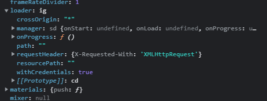

    Can you explain “However, when you load images with Puzzles (or JavaScript), this is entirely different story.” We made Verge3D as a vuejs component, it works well on same domain but when we tried to load img or gltf from another subdomain for example UI with verge3d is on live.domain.com and gltf and other files are on storage.domain.com we get CORS.
    We already setup “Access-Control-Allow-Origin: * on serverside.
    But somehow v3d is not sending headers to server.
    Can you help with that?
