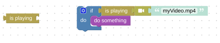

    How can we use this puzzle to restrict next sound from playing before previous sound completes ?

    I’d suggest you put all logic in the timer and check the status of the currently played sound periodically, say once a second.

    I tried it but looks like hell lot of work when it comes to multiple sound files.
    I combined several audio files together and reduced their count to make it easy to handle.
    Have a little suggestion – Can play sound puzzle have feature of “when finished do” ? similar like animation puzzle.
    So it will ensure the next track plays after finishing of the previous track only.
