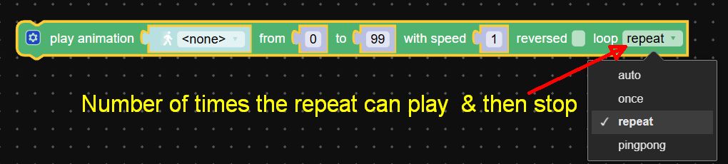

    Hi
    There is a little feature required in a Play animation Puzzle.
    The repeat count needs to have number of times the animation will play & then stop.
    Or
    how to achieve this in current set by using some puzzle combinations
    Secondly
    If the Auto is enabled then it doesnt respect the repeat count from blender “Repeat count”
    That can also be useful.

    You might use multiple “play animation” puzzles chained together (by using “when finished do” slot) to play animation several times.
    As for the “Auto” mode this is really an oversight on our part. We’re going to support this mode property in the upcoming preview build of Verge3D.

    Done! From now on the puzzle should handle loop mode and repeat count properly.
