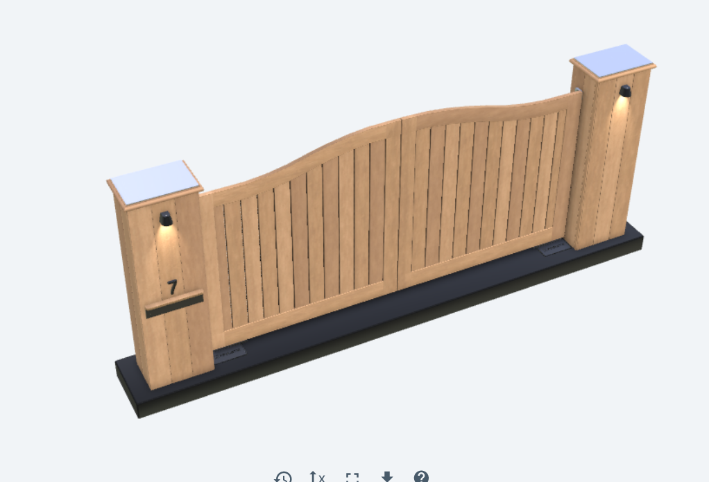

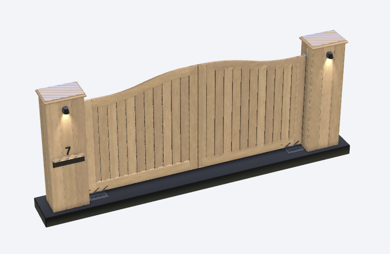

    Hello, the project we are working on renders fine on almost all machines we test on, yet there are certain configs that will create a lot of Z-fighting and cannot figure out why. I will attach images of the same model rendered on different machines.
    The one looking well runs on:
    chrome Version 96.0.4664.45 (Official Build) (64-bit) on Win 10
    Intel Iris plus graphics
    1920×1080
    also working well on:
    NVIDIA GeForce 980Ti
    3840×2160
    The z-fighting one:
    chrome Version 95.0.4638.69 (Official Build) (64-bit) on Ubuntu Linux 20.04
    NVIDIA GeForce GTX 1650 Ti/PCIe/SSE2
    wqhd 2560 x 1440
    Camera near and far limits have been adjusted, it did help it a bit, but still the problem persists.
    #46989
    this is known problem on Linux (see Chrome bug here). The only solution is to make proper near and far camera distance adjustments.
