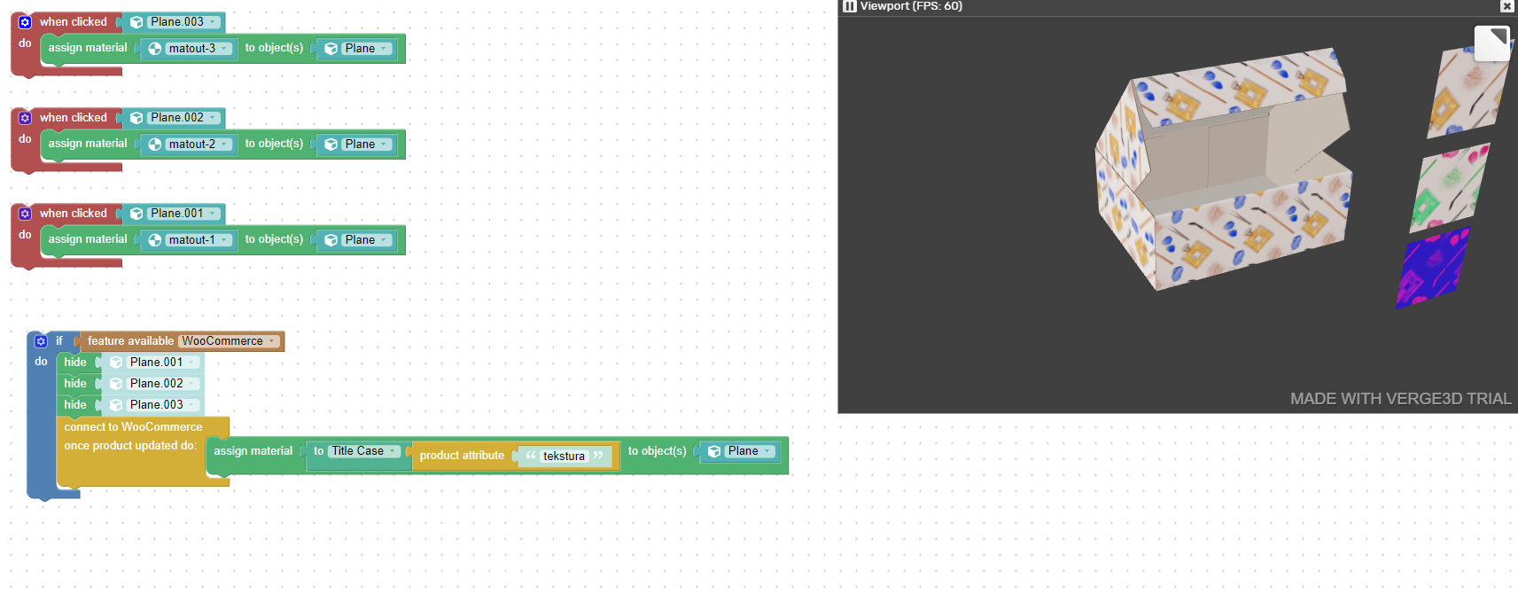

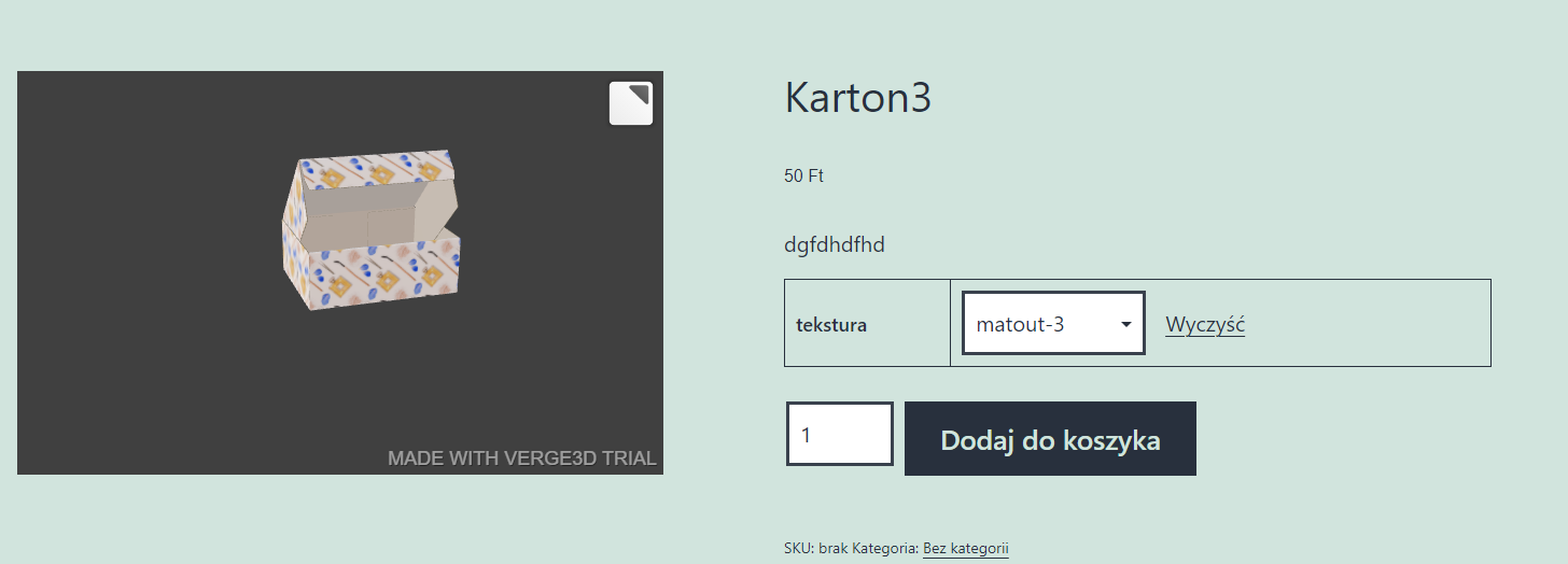

    I’m testing Verg3d for use with Woocomerce. When I test the Spinner demo everything is fine, in the woocomerce product view I can change the colors. When I test my design (textured cardboard), choosing a variant doesn’t change the texture. Below puzzle view and product view. What could be wrong?
    #42130
    The most common issue in such cases is misspelled attributes/material names. Please try to debug the attribute name by using console.log and double-check the name of your materials in the modelling suite.

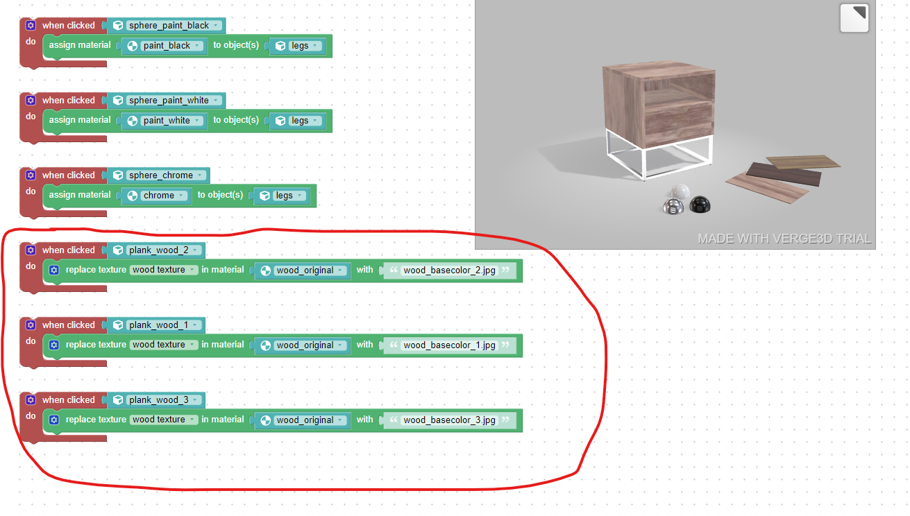

    I have a second question. In my store, I would like to be able to apply textures to an object similar to what is done in the sample application “Simple Configurator”, so that the textures can be applied from a separate .jpg file. Is there an example somewhere how to create such a configuration in a puzzle to adapt it to display in Woocomerce?
