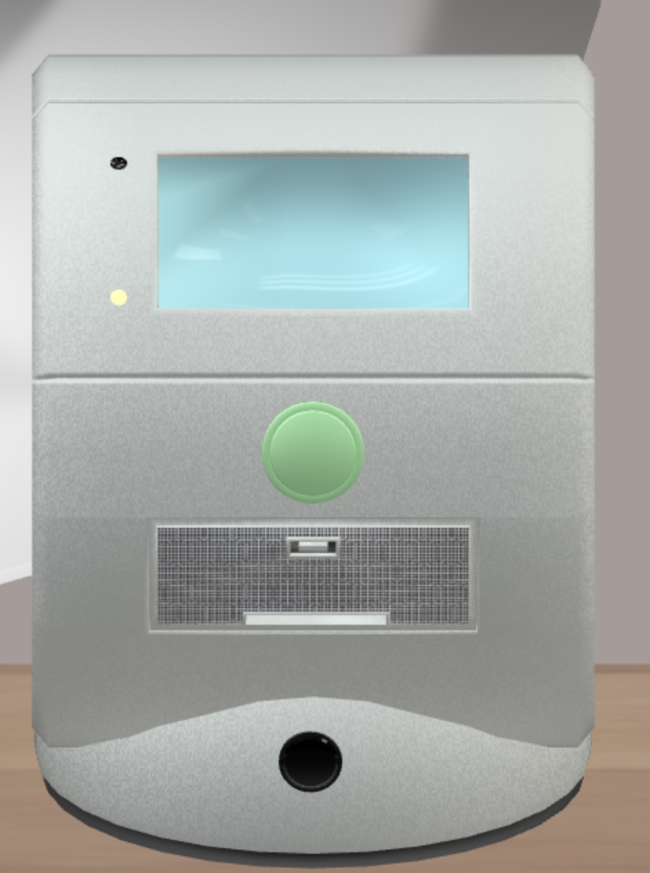

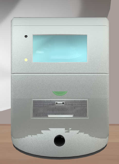

    Hi!
    I have an issue with weird edges on some objects in my scene. The phenomenon only appears in Chrome and Safari, it looks fine in Firefox and Edge. Is there a quick fix to this or is there a problem with the blender scene? :unsure:
    See attached images.

    You need to tweak far\near param of the camera. Try to set far as much closer to the size of the scene. Near something about 0.1 – 0.5 if it’s possible (usually it’s too low about 0.01 or less).
