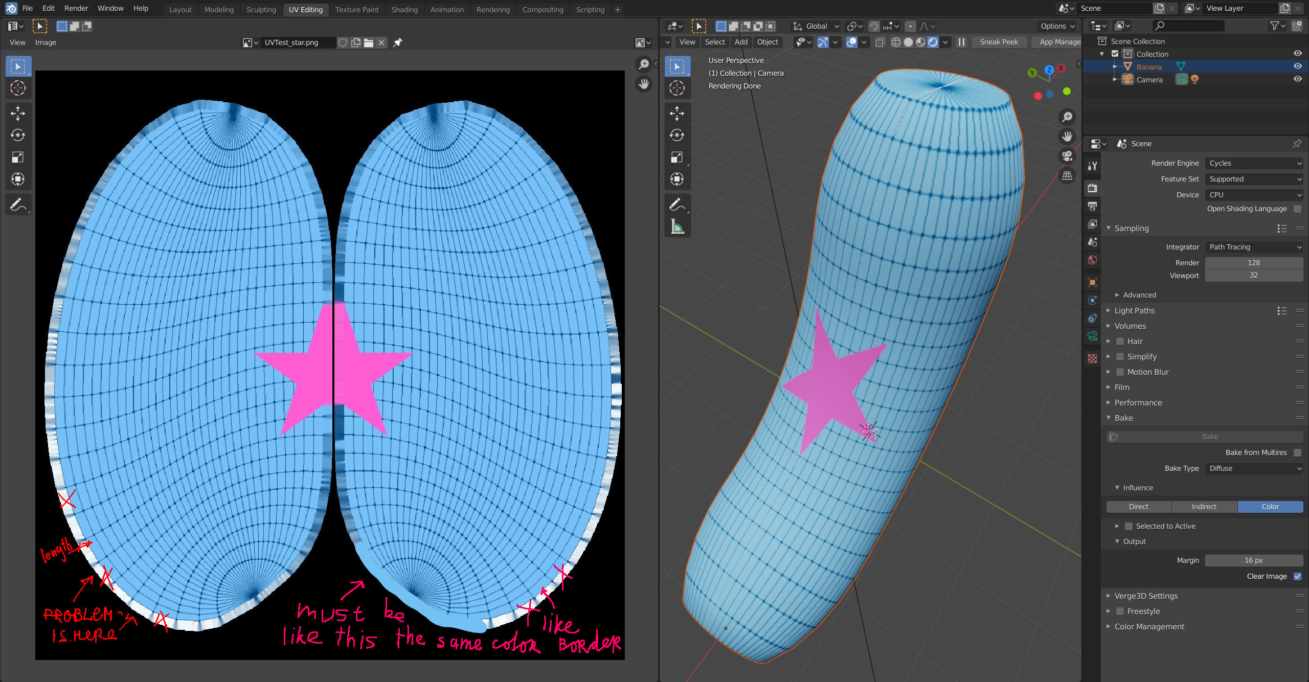

I have a banana like shaped object in a simple scene.
In Blender (2.82) I set a seam and UV unwrapped this object and applied a texture.
You can see that the black area of the texture is always a littlebig bigger than the UV vertices area (see UVEditor.jpg).In Blender I faced a problem that where the seam is sometimes a white stripe appears.

2020-04-21 at 9:52 am #26250mrburns
ParticipantHi,
I tried now what Mikhail suggested but it helps only partially.
I changed the texture image to make my problem more visible the main color is light blue now and I applied a pinkish star to the front side of the ‘banana’.
The result of texture baking (Bake type: Diffuse, Influence: Color only) you can see in the attached image (Blender_TextureBaking.JPG). One can see the 16 pixel margin that was created by Blender’s baking process.If I open ‘Sneak Peak’ the area where the star is seems to be quite good now.
But there is still a seam visible in the poles and the upper backside of the ‘banana’, see attached image ‘StillSeamsVisible.jpg’ (marked with red arrows).As I posted in my 1st message of this thread in Blender I could easily solve this problem by changing the interpolation type of the texture image node from ‘Linear’ to ‘Cubic’.
But it seams in Verge3D this has no effect at all. Is there any other way to change the interpolation type in Verge3D as well? Maybe using puzzles?The blend file and the baked texture file I attached to this message.
Thanks for any further help!

2020-04-21 at 10:14 am #26260
Mikhail LuzyaninStaffIt’s a common game development and game artist problems this solving usually like I said.
You still have some while lines and it’s happened because margins baked with some white color and when you zoom textures size change it’s size and this white mixed and added to the color on the mesh’s border, so you need to bake margin such way so they have solid color all int’s length with the same color like on border.But it seams in Verge3D this has no effect at all. Is there any other way to change the interpolation type in Verge3D as well? Maybe using puzzles?
Unfrotunally no.
