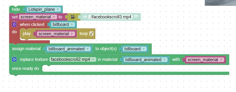

    I have two video files in a Verge3d scene that play ok in the puzzle editor but freeze almost immediately when the html file is opened from the application manager. The app loads ok but then freezes. What might the reason for this be? A memory capacity issue?
    Video can be played only by click of the user. So it will be played only if you setup the vido the way that it will be played on click.
    #28648
    g_hug
    I have set up the puzzles for the video to start on user click. In the html file, I can click and they start playing, but then they freeze.
    #28649
    Attach the project here.

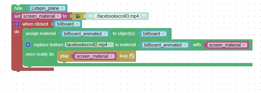

    #28675
    You’ve done it a wrong way, you need to stat to play video only after the video was loaded into the texture slot. Like it made in the example.
    Wrong:
    Right:

    g_hug
    I’ve set the puzzles up as you suggest but both the videos still freeze approx 1s after clicking, including the example fish video which I’ve imported into my scene (it works ok when I load the video texture example). Any idea why that might be? :unsure:

    #28707

    May be it’s cash after you update your app, try to reload your app after some delay. For me it helps and all plays ok.
    #28719
    g_hug
    That’s helped. Thanks! :yes:
