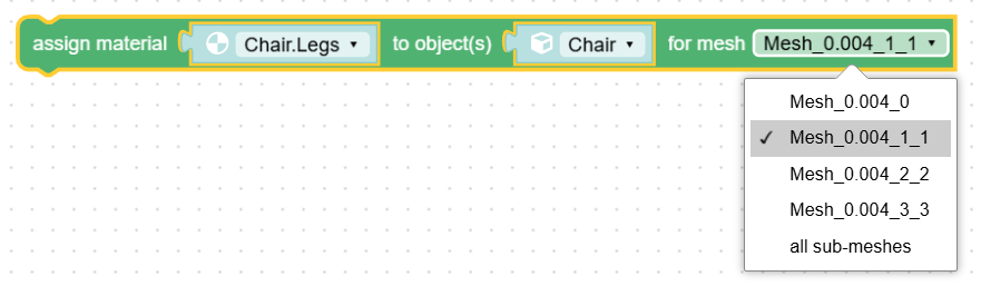

studiogijsCustomer@kdv77kdv no problem, it seems to work really well. I placed the material I want to change on top in the stack in blender, so that I can pick the first submat in the list easily, as it defaults to that. Then when I want to go back to one mat, I can simply add the material that has been assigned to the second in the stack, to the whole object the normal way.

1 step
Select the original object and select the slot you want to change on the cloned objects as well.Step 2
Replace the objects on the puzzle with the cloned object(s). The selected slot remains selected.2024-11-12 at 11:56 am #78603kdv
