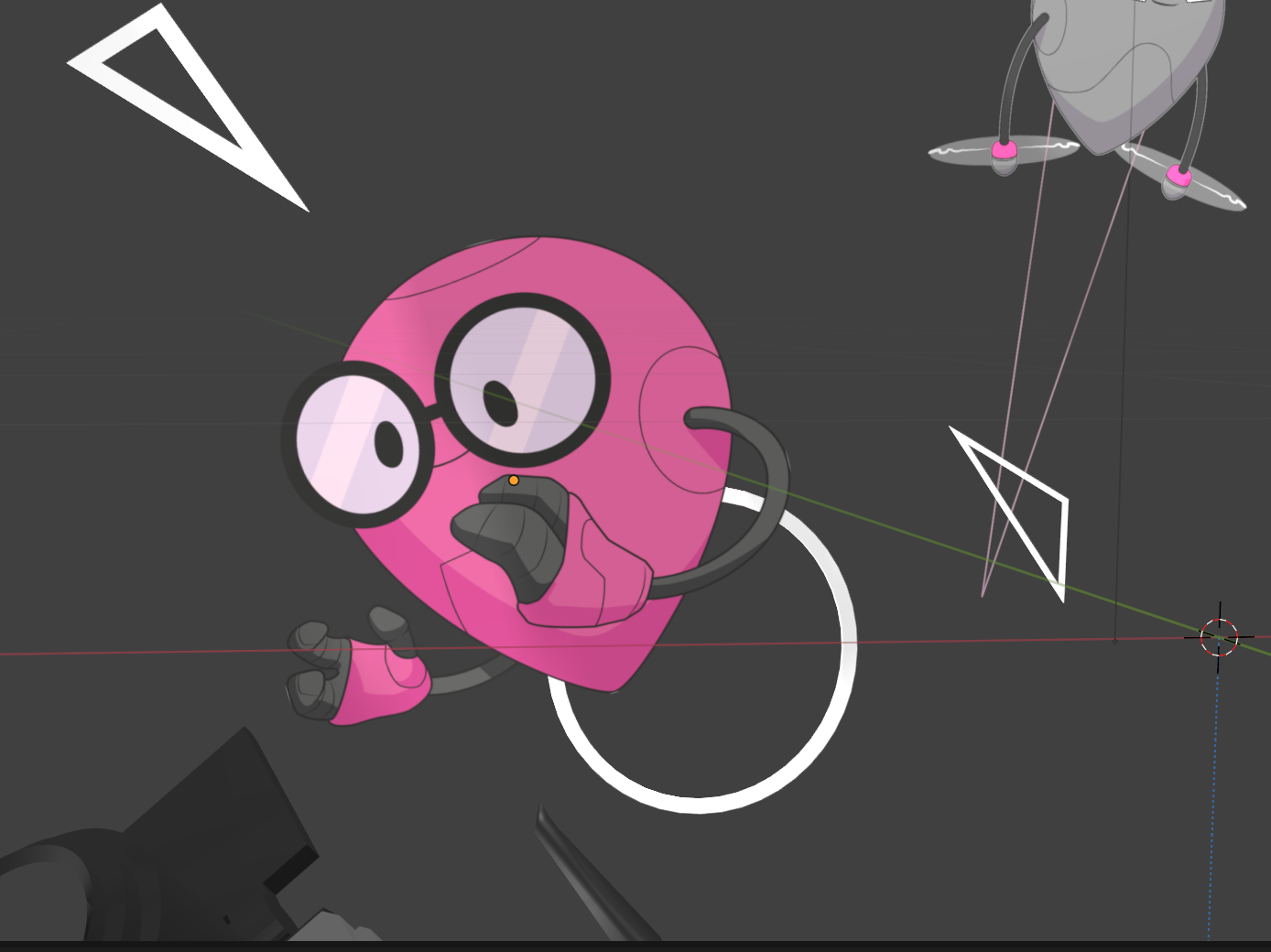

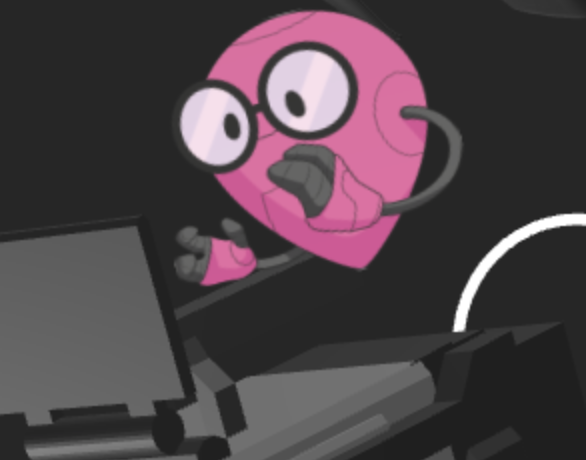

    Hi guys, so I’ve got a scene where a few elements are essentially planes with png textures applied to them, see attached the blender image and verge3D image. The resolution of these png’s are 1000x1000px and when rendered in blender they are pin sharp, but when verge3D displays them they’re pixelated. Is there some image compression going on with my png’s that I can prevent, as verge doesn’t seem to like svg’s? Thanks!

    Thanks for the super quick response! I re-exported out my texture as 1024x1024px, however I’m still getting the same issue with compression. Even tried it with 2048×2048 to test. Could there be anything else I’m missing?

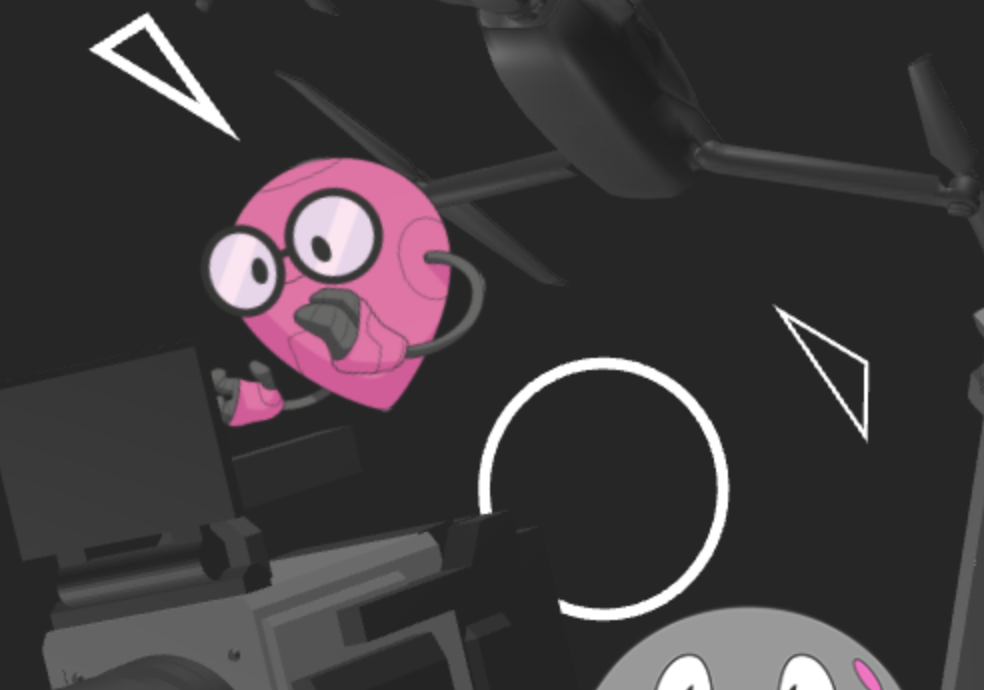

    coozoh
    Sure, here is the example
    I guess ideally I wanted to drop in svg’s into my work so it’s super crisp. Following previous advice I’ve dropped in POT images rather than NPOT, this is for the main grey robot and the left pink robot. Would you say this is as high res I can achieve with a png file?
