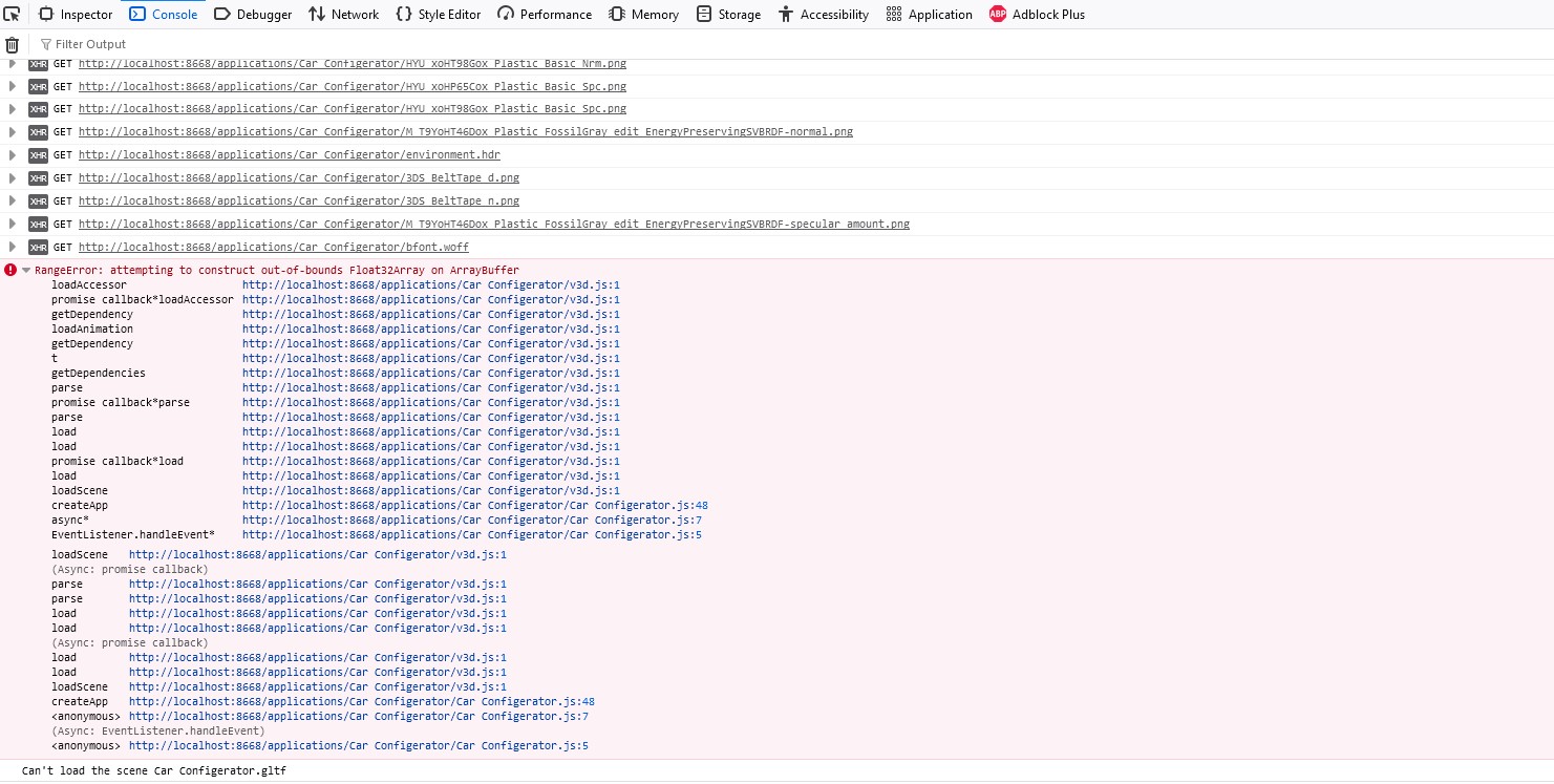

2024-06-20 at 5:34 am #75073
badbossParticipantWell, in this case your question has no answer
Nothing to say without the app itself.Actually I did discover this error upon
checking the Dev menu again, though I am not sure how to interpret it.
I could also attach the ZIP file via google drive I downloaded from the original computer and you could check out the app itself, would that help?Attachments:

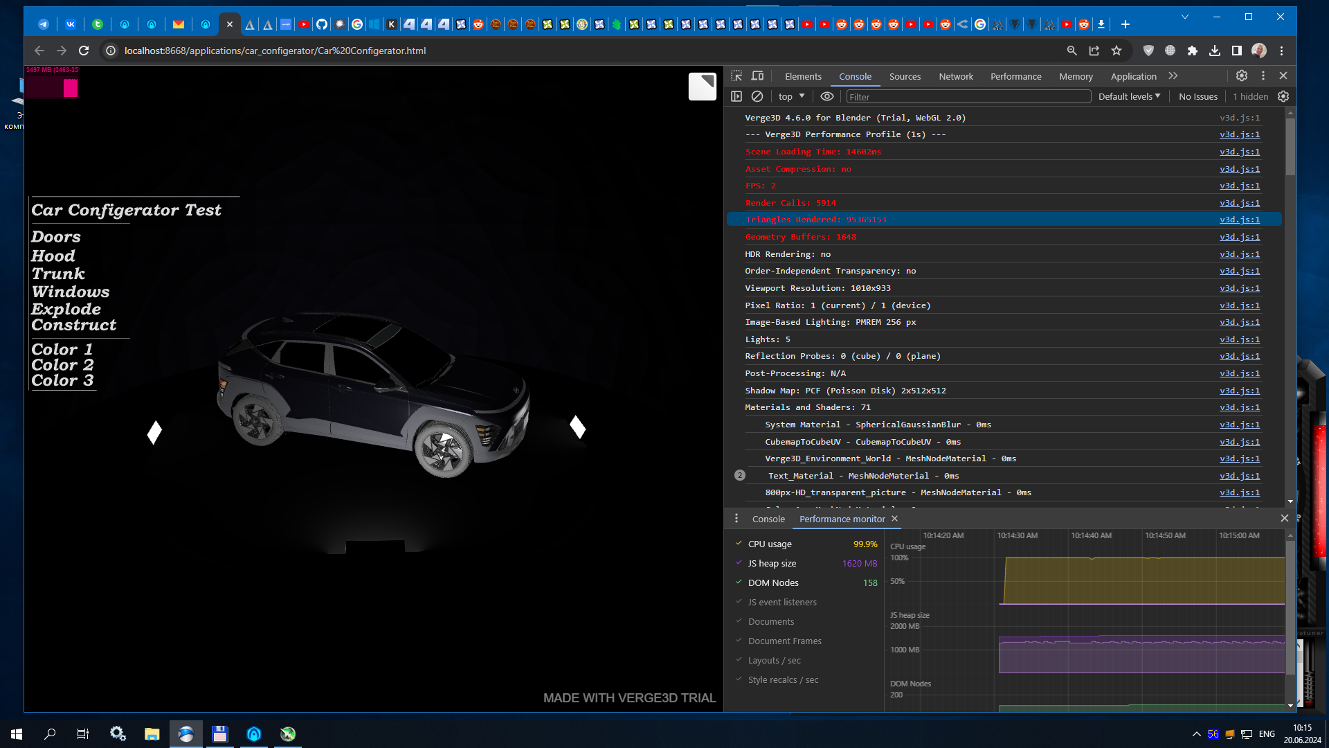

2024-06-20 at 5:58 am #75077kdv
ParticipantSee no loading issues but your app is tooooooooo heavy. It’s definitely not for web… 95+ million triangles? 5900+ render calls?
Looks like your home PC simply can’t cope with it. And all office computers also won’t. Half-Life Alyx in VR with Ultra settings is loading GPU and CPU less then your app
2024-06-20 at 6:13 am #75079
badbossParticipantThe car I used isn’t one I modeled, I knew it had a lot of verts but not that many haha. There was a lot of excess geometry I can cut out to reduce that, but I am not familiar with what render calls are. I am assuming it has to do the different lights I used in the scene reflecting off the model, or the animation of the car exploding. Do you have any other tips to reduce the heaviness of the app?
One thing that does confuse me though is the computer I constructed this app on ran it perfectly fine, and it only has specs slightly better than my one at home. Perhaps since I made the app on that device it can work there, but transferring all the data on the web is too much? Thanks for taking the time to check out my app.2024-06-20 at 6:16 am #75080kdv
