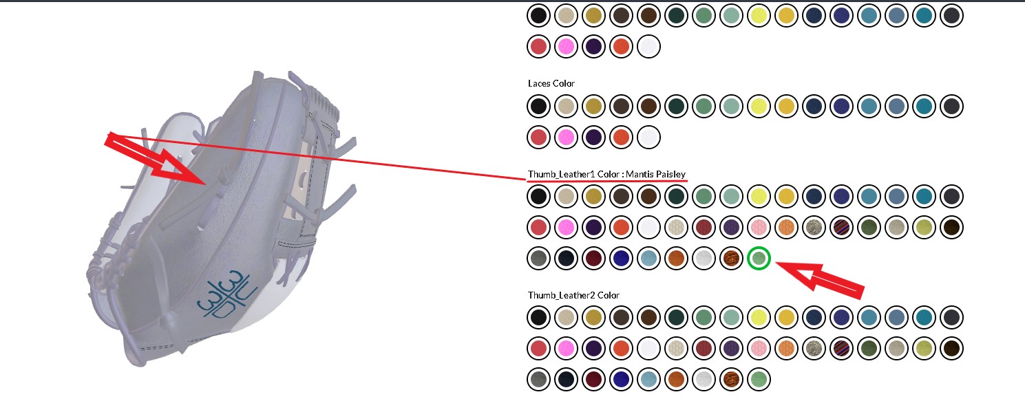

I’m encountering a perplexing texture loading issue within the Verge3D WordPress plugin. I have a 3D glove model with customizable paisley patterns. The paisley textures are applied to separate planes that were created in Blender and exported to Verge3D.
The Problem:
While other textures in the scene load without any issues, the paisley textures are not displaying on the 3D model. I’ve confirmed that the paisley texture images exist in the same directory as the other working textures.

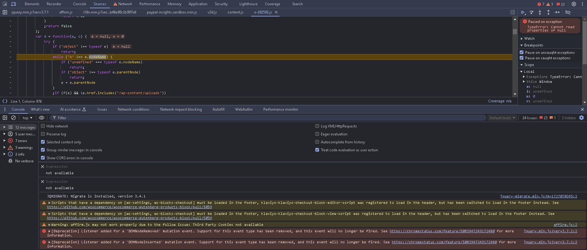

Customerin checking the developer console, I am seeing the following error, which is odd I do not have this issue with the other options.
visual_logic.js:290 Uncaught TypeError: Cannot read properties of undefined (reading ‘thumb_leather1-color’)
at visual_logic.js:290:48
at wooProductAttribute (visual_logic.js:291:8)
at PL.init (visual_logic.js:2867:5)
at Palm Pull Through.js:53:20
at v3d.js:1:1416503I have confirmed the puzzle is properly setup.

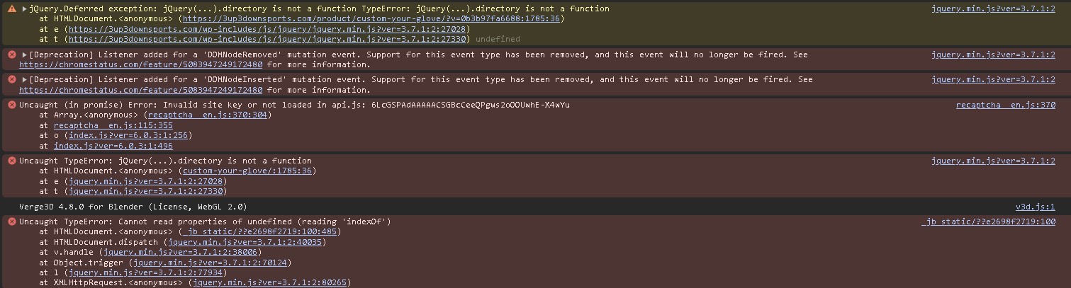

2025-02-04 at 7:39 am #800683up3down
CustomerThank you for your response. I did as you suggested, however, unfortunately I am still having problems. Attached are the error messages I am seeing in my chrome developer console. Based on these errors come on do you have any additional recommendations?
Your assistance is appreciated as I have been working on this for some time to troubleshoot.
