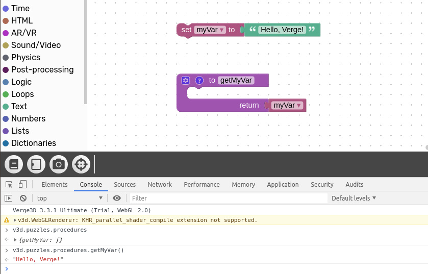

GLiFTeKCustomerrunCode(app) is somehow firing BEFORE puzzles are completed.
( which i thought was the reason for the runCode… to fire after puzzles.)
i have this to return the image name variable from puzzles…
var imgName = v3d.puzzles.procedures.getImgName(); console.log('imgName: ',imgName);the console is printing imgName: undefined BEFORE my print to console puzzles are printing my concatenated imgName var, puzzles prepare to deliver.
my puzzles:
plz share Discord link & on your signature!2020-08-18 at 4:51 am #31671
Yuri KovelenovStaff2020-08-18 at 5:44 am #31673
GLiFTeKCustomerIn Puzzles, you have an asynchronous procedure call (load data – once ready do). So you should initiate communication with your code only after your SVG file is loaded.
right but that leads us back to the fact that i can’t tell runCode(app) WHEN to run (that’s for call js right?)
the canvas texture code has to be in the runCodeapp not the external interface as shown in the user manual.
so putting anything in the when finished … etc.. would have to be a call js.. not the runcodeapp.. where.. the canvas code works…
plz share Discord link & on your signature!2020-08-18 at 6:30 am #31674
Yuri KovelenovStaffRight, the sequence is that you load data first, and only after that you can use it in your code.
So in your code, you have to perform the call for getting your variable value only after the data are loaded.
A convenient way to do this is to use this method:
If you use the variant of call js function with return value, then you can pass your variable to the code at the same time.
