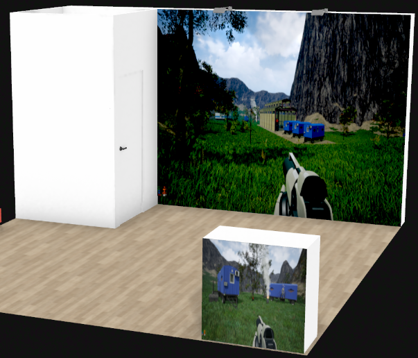

    I’m trying to upload different images to multiple objects
    but i am ending up having multiple objects sharing the same texture.

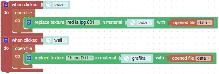

    I think you have to create a different material for each object, and then manage the upload for each material.
    #54766
    netcraft
    No, i’m doing something wrong.
    both wall and counter (=lada) load same image on click.
    how to solve it ?

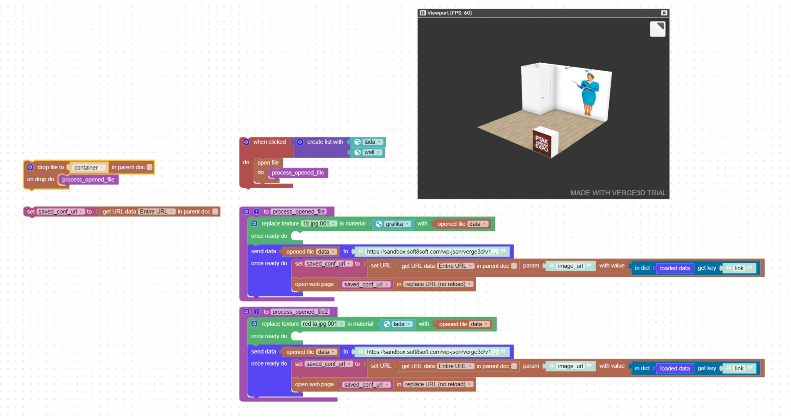

    Is that what you want?
    Or you want to have clones (chairs or smth else) with different textures?
    #54771
    netcraft
    yes, :) thank you

    It’s all fine, my description was unclear. Your answear solved my problem. :good: :good:
