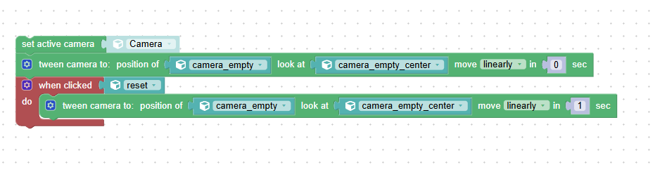

    I’ve an orthographic camera (blender) in my scene that has a locked vertical rotation limit.
    The minimum and maximum are set at the same angle of 64.
    I want to use the Tween Camera To puzzle to be able to reset the camera’s position (send it back to the location of an empty).
    This puzzle causes a little jerk after the Tween Camera has executed.
    I’ve tried to work around the issue by disabling the limit before the tween and activating it again but the same little jerk happens.
    Is there a better way of doing this so i get a smooth transition?

    Perhaps the angle to the required camera position is not equal to 64. Try to tweak this position a bit.
    #81077
    huib
    Thanks!
    Found the correct number by finding which way it “jerked” (up or down) and honed down till it didn’t move anymore. That was driving me crazy!
    I assume this has something to do with the angle of the camera not being the same as the vertical rotation angle limit.

    This might help
