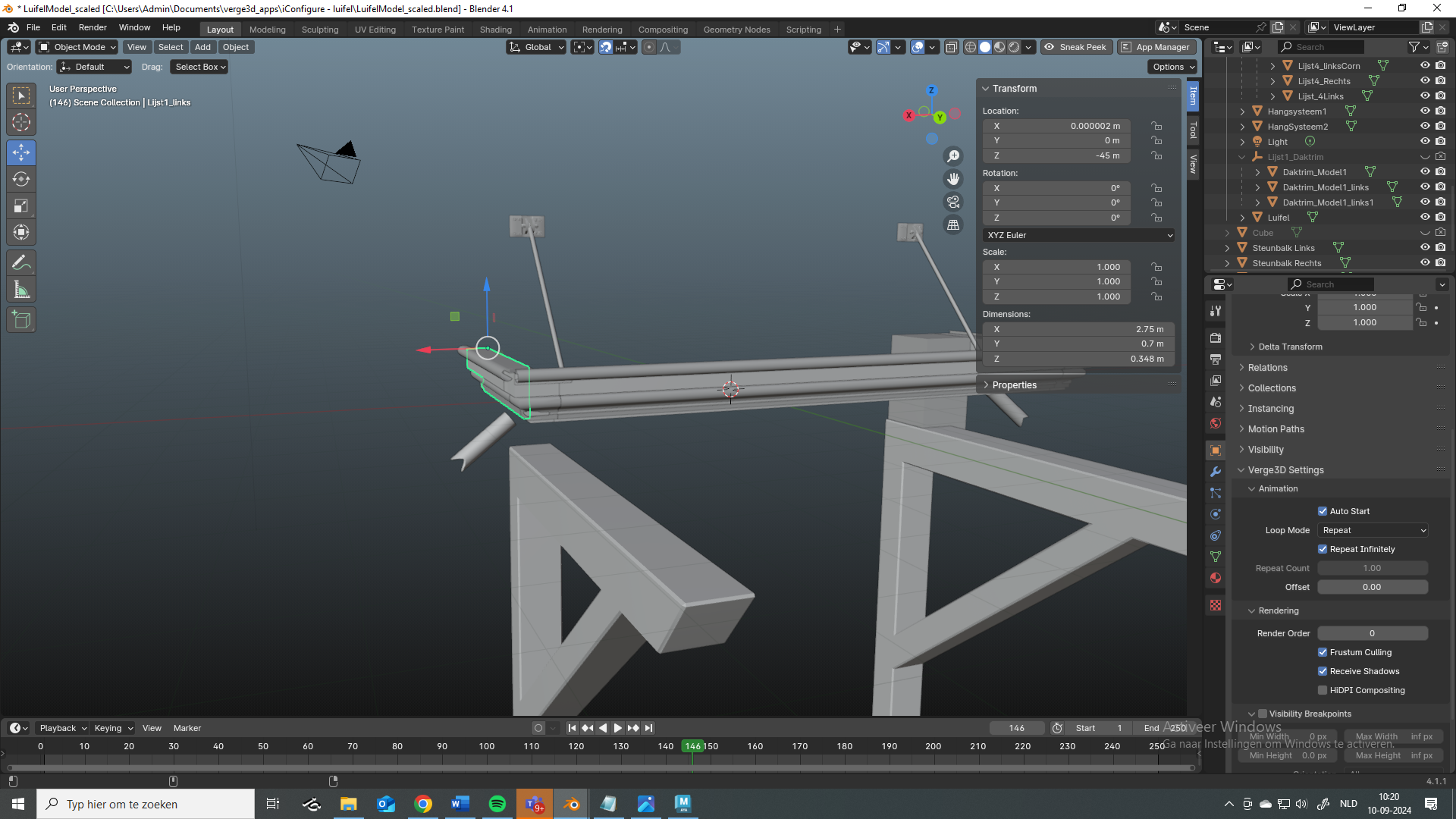

ParticipantHi there,

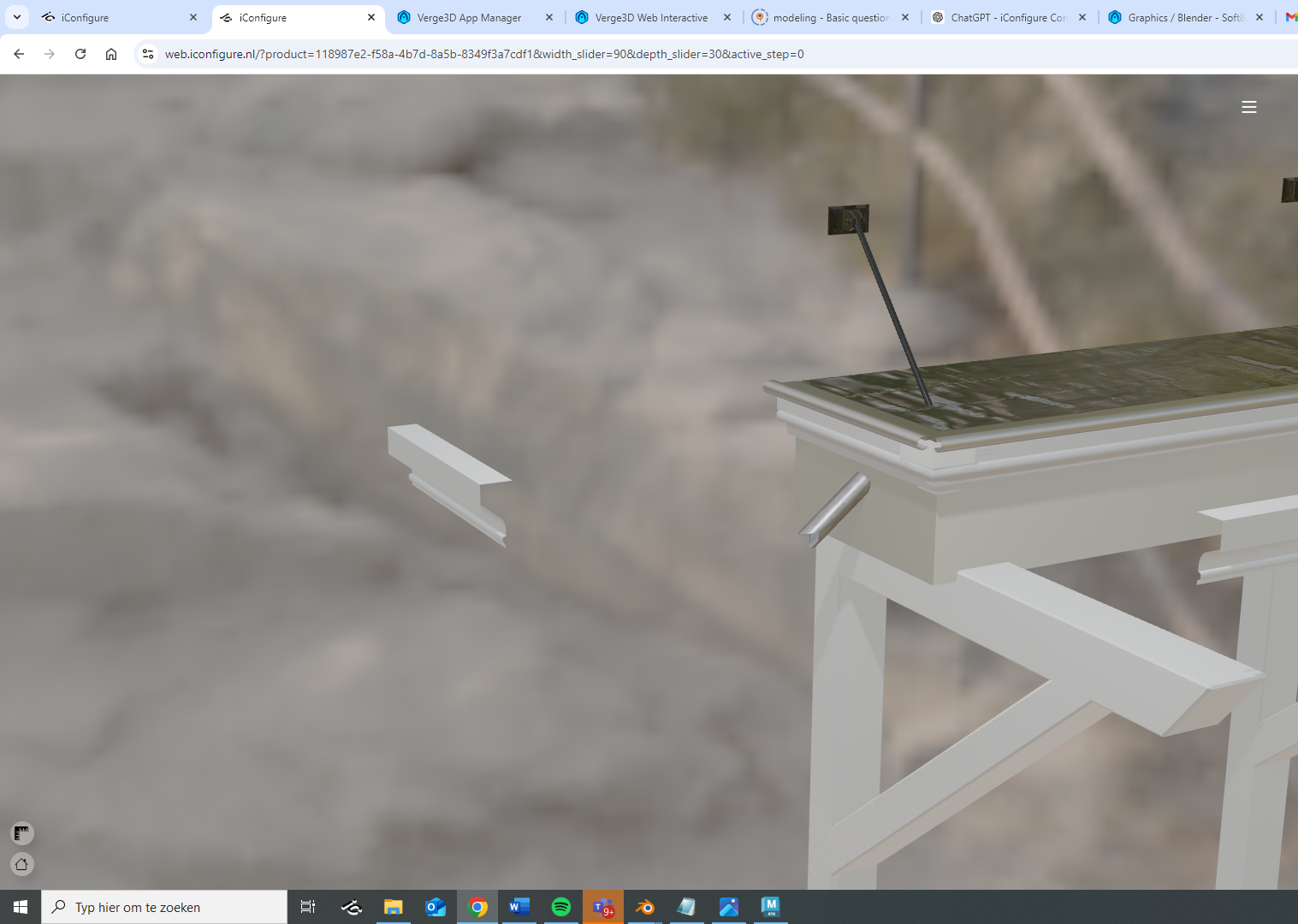

I am quite new to Blender, since I have moved there from Maya. I am running into an issue with transforms and how they translate to Verge3d. In my viewport in Blender I have an object set to the location: x 0 ; y 0 ; z -45 . The z axis has to be moved from -45 to -125, I used an animate param node for that.
Once I input those factors into Verge it does not align at all. When the object is set to -45 it jumps twice as far to the left. And when I change it to 0 it does not align either. When I do “apply location” certain models jump to an illogical place in the scene, not where their origin is. I hope somebody has an answer for this.
Btw, the models were made in Maya. Maybe that factors into it.

xeonCustomerOk…two things come to mind that you can validate
1. If your object has keyframes…then be sure to set the play animation to frame 0 and not let it animate. You can also achieve this in Blender by unchecking the AutoStart option.
2. Setting your origins. Since you are new to Blender its possible your origins are not where you think they are? To validate add a simple default cube to your scene at 0,0,0 and scale it to fit your scene. Apply the scale. Then go in the V3D and see if the cube is at 0,0,0. then try to move it to along the z axis using animate parameter. If it works…then the problem is with orgin of your object. Please note that if you Apply All or Apply Location …the origin moves back to 0,0,0. So you would need to reset the origin.

CustomerAlso check if your are moving in LOCAL or GLOBAL coordinates (by default the puzzle moves the object in local coordinates (or parent coordinates if your parented the moving object to another). If you want to move in global coordinates you need to tick the “world” option of the puzzles.
This, together with what @xeon describes above, is the key to getting what you expect when trying to move your objects with Verge3D.
