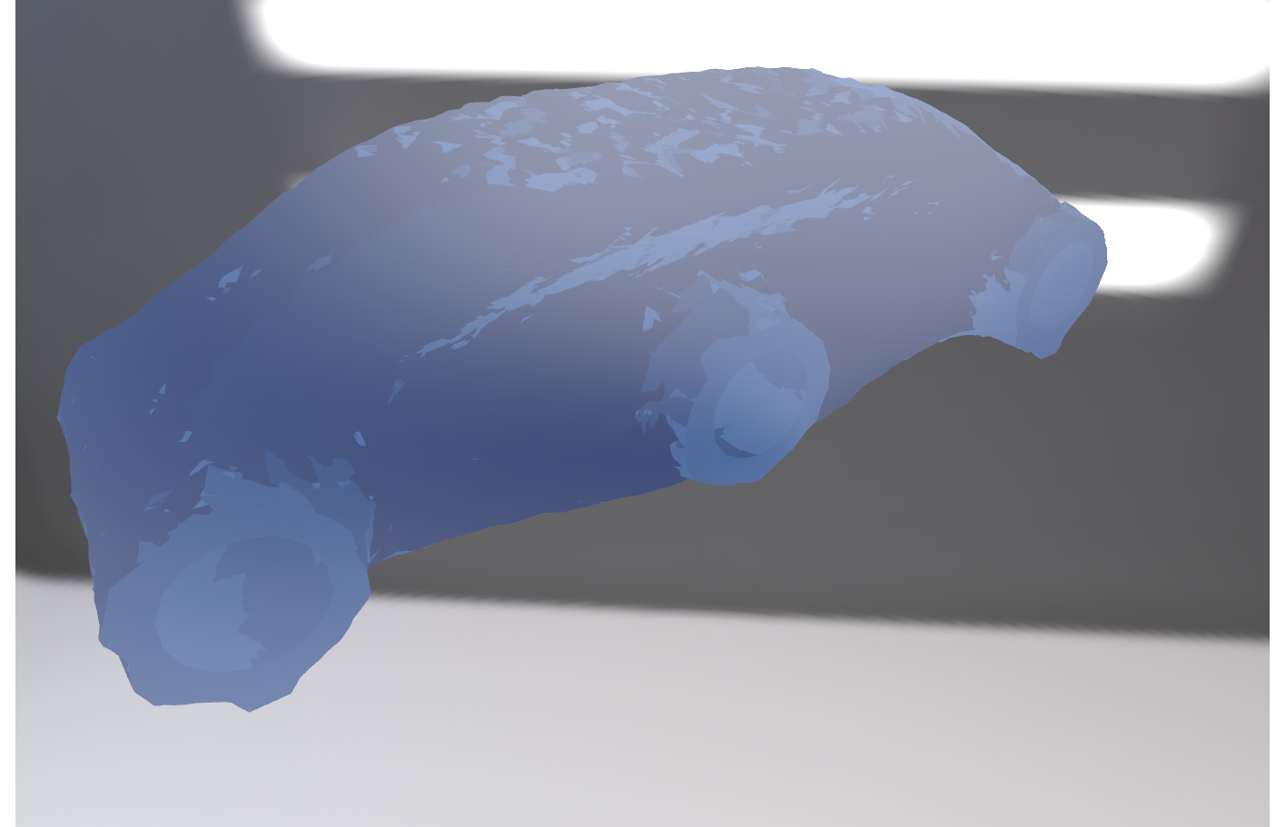

    Hi Gurus.
    As you can see in the images below, HTML version is not showing the textures of the object properly which I set it in the blender and could be able to see there.
    Any clues I can try out? I would be so grateful if you can share some ideas.
    Thanks for your help in advance.
    #44292
    Lee
    It solved when I reset the camera scale to 1 back.
    I wonder how the its scale affects it.
    Anyway, thanks for checking in everyone.
    #44314
    Glad you worked it out! Indeed, camera scale must be 1 for Verge3D (we’re working on it).
