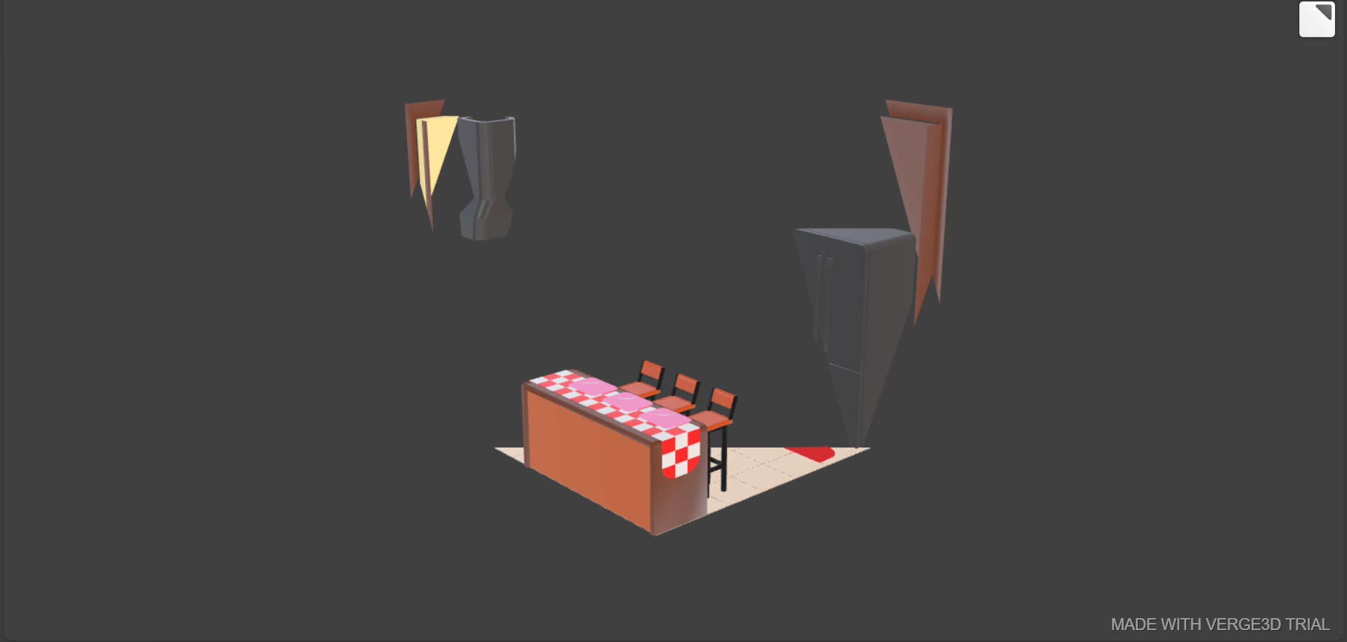

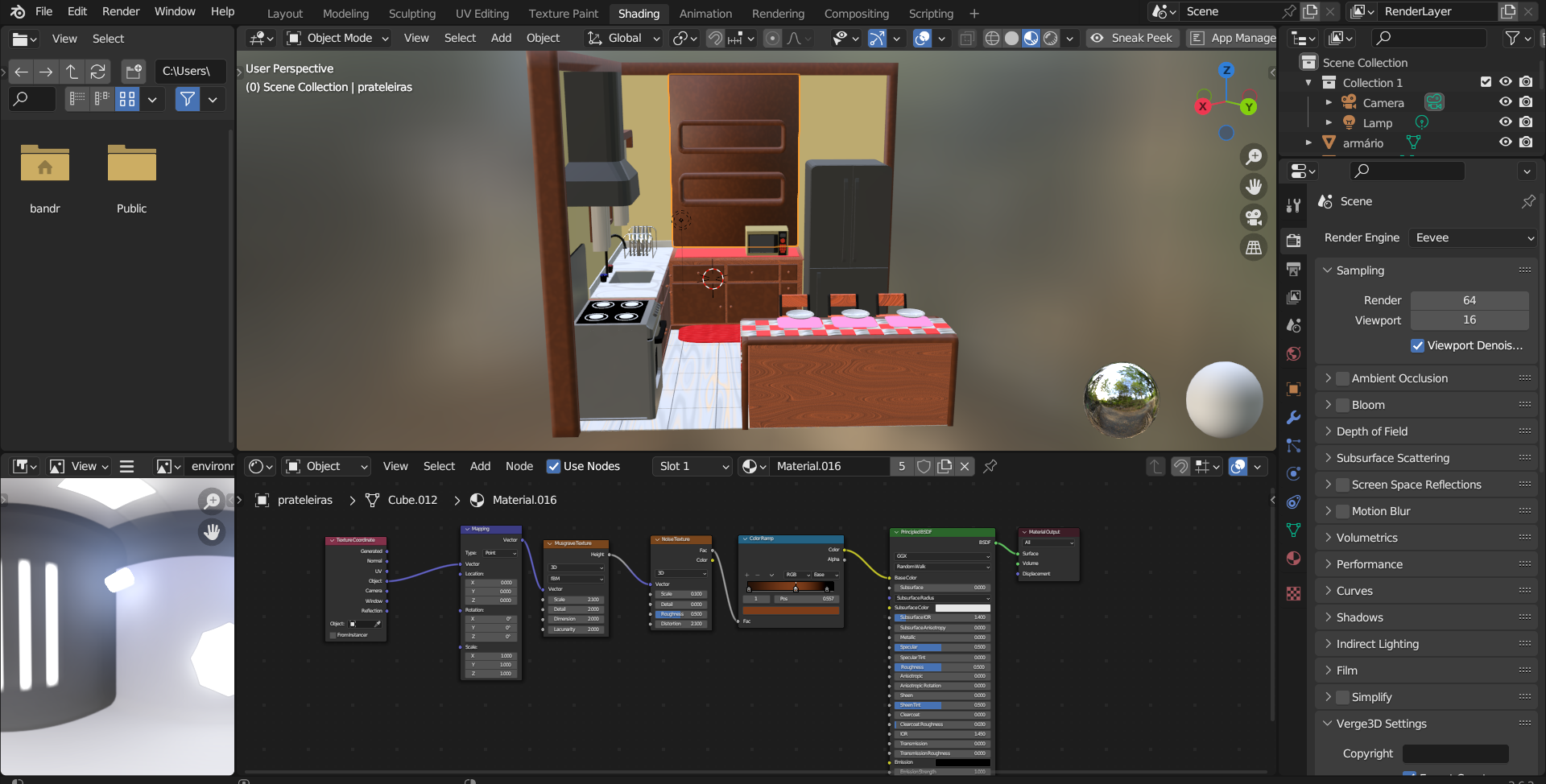

    I’m a starter at Verge3D and have only watched the Swiss Army Knife tutorial so far, which I could finish successfully. Now I’m doing some experiments with a model my friend made but I’m having problems with the textures. The difference from both of the two projects is that one used image as textures and the other used Blender shading only. I’ve attached images where you can see what happens after I open the model with HTML or GLTF.
    Plus, I’m getting this issue with the camera (third image that I uploaded) that I think is something simple, but as I’m already here, asking for help about it too.

    Supported nodes
    https://www.soft8soft.com/docs/manual/en/blender/Shader-Nodes-Reference.html
    MusgraveTexture is not listed there…
    increase far clipping

    We’ll consider implementing Musgrave node in the near future. Stay tuned!

    unfortunately the Musgrave node was dropped in Blender 4.1 +. Please use the regular noise texture as a replacement. See here for more info.
