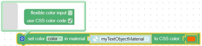

    #59846
    This object will have a material, so you can change its color as usual https://www.soft8soft.com/docs/manual/en/puzzles/Materials.html#materials_set_color

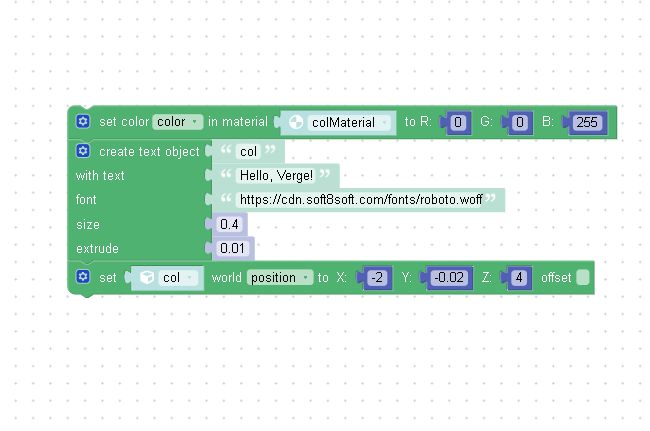

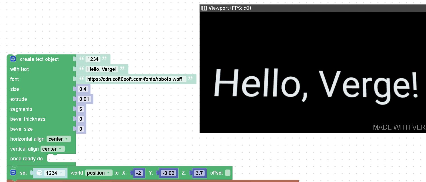

    #59854
    saurav
    Actually, this is just a text I created using puzzles only, so there is no blend file for it. So, is there any way I can use puzzles or CSS to change the color for this text ‘Hello, Verge!’.

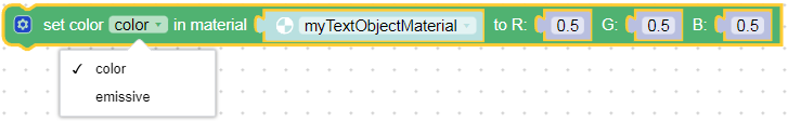

    #59860
    saurav
    The options ‘color’ and ’emissive’ are not showing in my set color puzzle

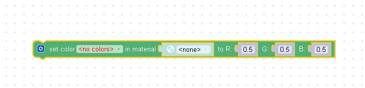

    #59862
    First you should choose the material. <none> is not a material, it’s nothing. In your case it will be 1234Material
    Also you can use CSS colors
    #59864
    saurav
    I selected the material and applied the puzzle, but the text became blue for a second and reverted back to being white again.
    I think there is some small setting that I am missing, because the color did change for a second there.

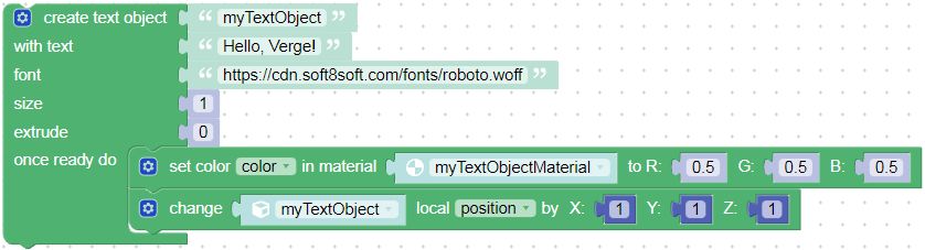

    #59866
    place this puzzle inside the once ready do slot. according to your puzzles you are trying to handle the material that hasn’t been created yet. the same with changing the object’s position…
    #59867
    saurav
