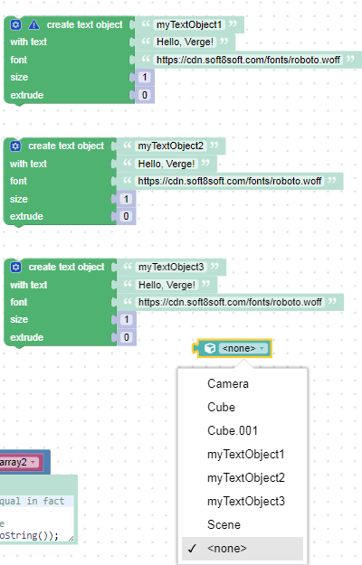

CustomerI hate to keep bothering everyone but this puzzles thing, I just don’t get. I’m trying to create two separate text as objects. I can create as many as I want. But only the first can be modified. The second one does not show up as an object. For example, if I want to change the position of the second one the drop down menu does not include the name I assigned for the second text object. For reference the names of the two objects is “TextObject1″ and TextObject2”.
Any help would be appreciated.
2023-05-31 at 2:36 pm #64209kdv
ParticipantIf you want to see the names of newly added objects just save your puzzles and click the Play button in the Puzzles editior. This will force the puzzles’ logic to be executed and the names will appear in the drop-down list.

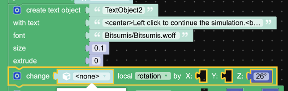

2023-05-31 at 9:35 pm #64220vergecurious
CustomerNot only does MyObject2 not show up, neither does MyObject1. I have no idea what to look for in the Console.

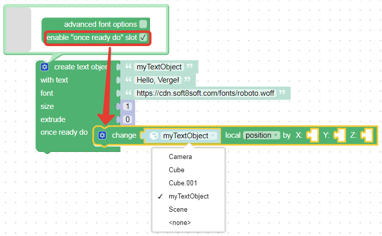

2023-05-31 at 9:46 pm #64222kdv
ParticipantIt won’t work this way.
Creating a text object takes some time, mush more than 0-1 ms. The object can be moved only after it has bee created, not earlier.

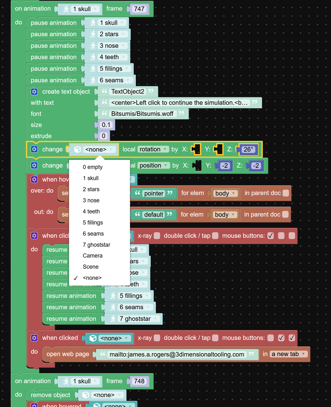

ParticipantTextObject2 will be created only at the end of animations. It’s not existing in the scene till that moment. When the animation is paused for the first time you can see TextObject1 (TextObject2 is not existing yet), on the second pause you will see TextObject2 (TextObject1 is already removed and not in the list). Everything happens according to your logic, no issues at all.
2023-06-01 at 4:06 am #64241vergecurious
CustomerWow, thanks so much. I never would have gotten that. I assumed all objects were collected on start up. Thanks for putting up with me.
2023-06-01 at 4:10 am #64243kdv
ParticipantRe-download visual_logic.zip
Except those ones created some time later. They are visible in the list only after they have been created.
