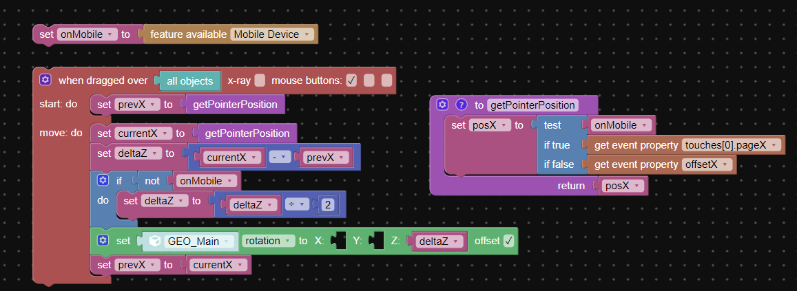

    I’m using puzzles to rotate an object when the user drags their pointer left to right.
    Works fine, except when the pointer leaves the container/window – if I re-enter the container/window, the rotation “pops” to reflect the entry position of my pointer :-(
    This is an issue since I will be having the scene in an iframe in another page, and when the cursor exits the iframe element in a mouse/pointerdown state, the rotation stops, but when the cursor re-enters the iframe element, the rotation not only pops, but acts as if I’;m still in a mouse/pointerdown state, as if I’m dragging even though no buttons are pressed.
    Please help! I’ve been trying to use various HTML event puzzles to address the issues, and would be super-grateful any insights/suggestions.
    #76958
    The code is correct..the problem is the “All objects”. This is a non itterable object selector and for this to work the way you want it needs to be an itterable object like an object, group, collection.

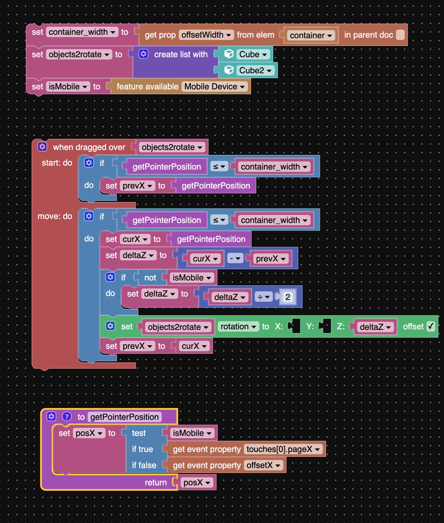

    Ok…I have been trying to recreate the problem you are having and I just cant make it happen.
    To test the theory out I created a scene with just a cube. I took the Camera and set it so that it does not have any controls. It can’t orbit, cant pan and cant zoom. This was important because often if you drag on the canvas the orbit Camera will take over and that will rotate while outside the canvas and that was a bit confusing.. when I was testing the drag over on a object.
    When using this setup dragging over an object stops for me as soon as the mouse leaves the canvas… however…. i created something else to ensure it stops….give it a shot.
    basically added the width of the canvas container to be the limiter of the drag.

    #76968
    Ok…after watching your GIF…I think I miss understood the problem you were having.
    In situation you are showing the mouse leaves the canvas at X and then renters the canvas a X+n and upon re-entry the object snaps to the mouse due to the new “current location” of x.
    The code I provided will not fix this particular issue. I had thought that you were dragging on the x… then returned from the same X starting point…so if you exit with X=0, you returned at X=0 but what you are doing is exiting the drag ie. X=10 and then returning from out of canvas to immediately appear at X = 400 and the cube rotates to face the new location making it “jump” for lack of a better phrase. Its not that the mouse is not rotation is not stopping…when the mouse leaves the canvas….its your re-entry point.
    If the requirement is really that a person rotates the object leaves at X=0 and can return at X=500 and the object has to assume the entry point is the new x=0 so that the cube resumes the same rotation point regardless of where the mouse enters….??? I am sure it can be done….I know I haven’t tried to solve for that one…but I will think on it.
