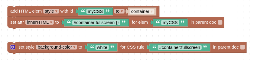

    or even do it merely with puzzles, for example:
    – this will just make the background white in the fullscreen mode.
