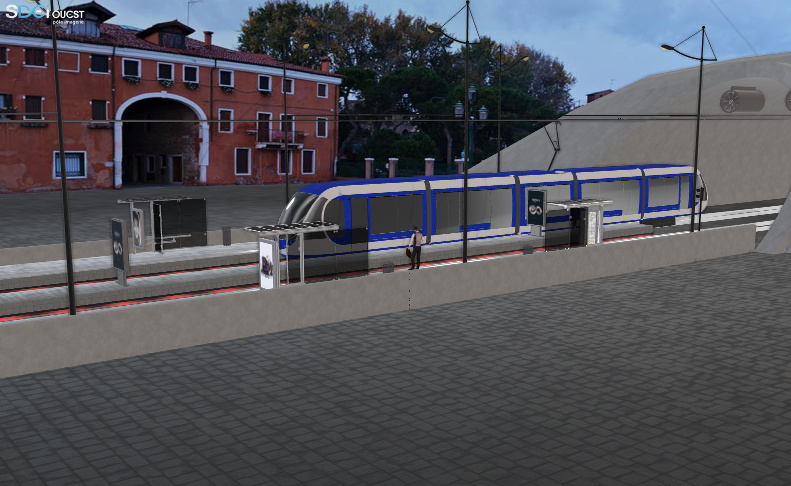

2020-07-07 at 9:08 am #29743Retailleaum
Customerit works really well. thank you very much
https://cdn.soft8soft.com/AROAJSY2GOEHMOFUVPIOE:d793dccbf8/applications/Sido/Sido.html

GLiFTeKCustomerYa nice job.
I had to check it out in Firefox and Chrome cuz I thought there was a bug.
Nope.., just one of the many pet peeves I have of the DuckDuckGo privacy browser I use were the bottom 8th of the screen dips down, in your case, removing the bottom UI menu icons.
Bleh. …tradeoffs 😕Visit the GLIFTEK Verge3D Plugins Store!
plz share Discord link & on your signature!2020-07-07 at 5:49 pm #29783
scalareCustomerWow! Very impressive! I got surprised because one of the trains moved through me (I happened to stop the orbit camera just on the tracks), and I was able to see the wagons from the inside as they moved forward
2020-07-07 at 6:45 pm #29785
illussimoCustomerWow, this is gorgeous and exciting. Also what you did with the waiting passenger and the serene atmosphere.
