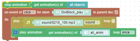

    Hey hope you are well and what a great software Verge3d is!
    I have a simple puzzle (see screengrab) for my scene with a rigged characters with a lot of bones that have animation on them.
    I was hoping it would:
    -stop all animations from playing
    -start all animations and play the sound when a button is clicked
    I need to do the start/stop the animation with the puzzle as there are just too many bones to individually turn the auto play off in the attribute editor in Maya.
    What I am I doing wrong? Thank you so much!
    #53452
    all objects puzzle instead of all_anim. btw, all_anim must be a group of objects, but in your case it’s just a single object…
    #53472
    You can also create a list of specific objects/bones and use the list variable in the play animation puzzle.

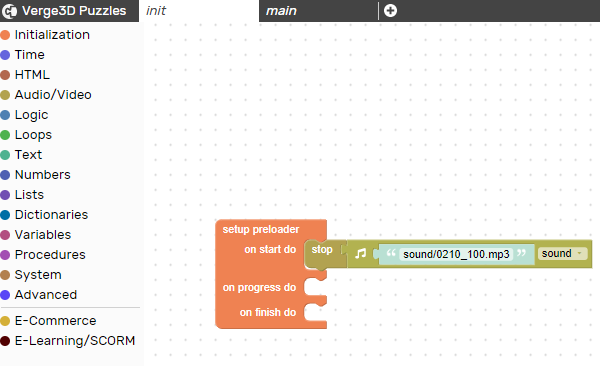

    Thanks for the help @xeon and @kdv77kdv! I did create a puzzle for the initialize process (see screengrab) which works on a web browser but on my iphone the animation plays with no sound…… feel free to have a look here:
    https://www.jayceee.com/wp/dakini/showcase/b/b.html
    #53479
    Chrome
    The AudioContext was not allowed to start. It must be resumed (or created) after a user gesture on the page. https://goo.gl/7K7WLu
    Safari has the same restriction. Do not activate your animation/sound on load, do it after a user pressed the key, like it works now…
    #53484
    Set the root bone in verge3d settings for the base of the armature in Maya|Max and you will see all your animation as one animation in selectors puzzles.
