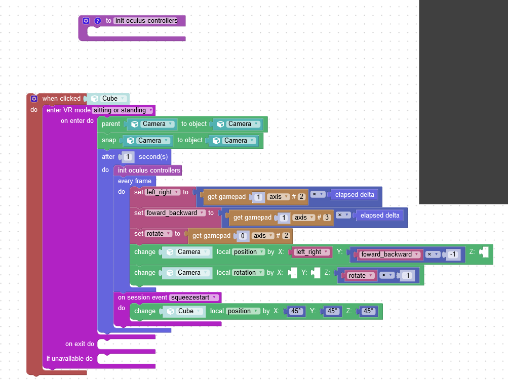

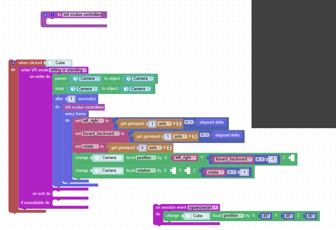

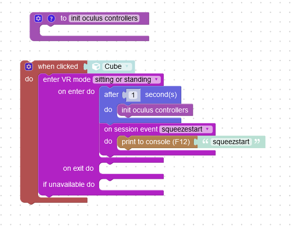

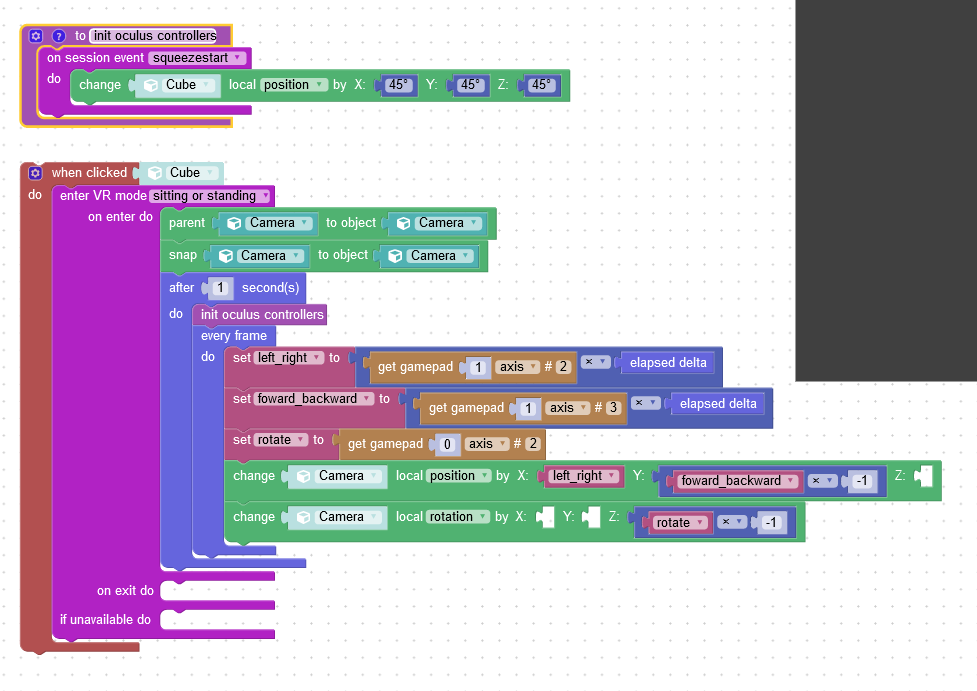

    Good morning! I have one question which has been hindering my progress tremendously, how can I pick up an object, or even just register a trigger squeeze. Please help as I am really trying everything and are out of ideas and options. None of the attached work, they just cause the browser to hang indefinitely.
    #39252
    looks like you’re trying to make a really huge jump (45 meters in all directions). Use regular numbers, not degrees to change your object position.
    #39254
    ocularvr
    Hi Alexander, I changed the puzzle to rotation (45 degrees) and the same result. I would like to know how I can get the Squeeztrigger event to register, just a print to console would do.

    Hi Again,
    I tired all possibilities and am just able to get the squeez-trigger event. Please see the attached steps. Not sure what else can be done. My finality is to pick up an object by squeezing the trigger and moving it around until trigger release. I am a long way away. I am on 3.6.0 and Windows 10 with Chrome/Firefox.

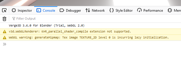

    How are you checking in the console debug window in VR mode to see if your squeeze event fired?
    Answer: you are not in VR.
    I haven’t had the chance to figure out proper debugging in the oculus browser but I believe it involves using a USB cable (at least at first). Which is probably why I have been avoiding it (**if anyone has a guide on this subject it would be appreciated if you shared it!**)
    If you need a simple debug, like printing “squeeze event happened!”, what I did (since I am too lazy to get out a usb cable) was add a text object to my scene, then use update-text-object puzzle to change the text object to whatever my console print message would be.
    If you set it up on a fire on every-frame puzzle, be warned your frame rate will get crushed as converting text to new objects is a heavy load on the system.
    I haven’t looked too closely at your example puzzles as my guess is you upgraded then forgot to switch your default directory in your SSL xampp server setup you’re testing from? I know I have done it before where change after change and refresh after refresh seemingly has no effect until you realize you are loading the right file name, but in a different location.
    If that’s not your issue, continue to trouble shoot. The update-text method I mentioned above should help.
    Unless you cannot even get into VR mode to check (meaning its hanging on launch)

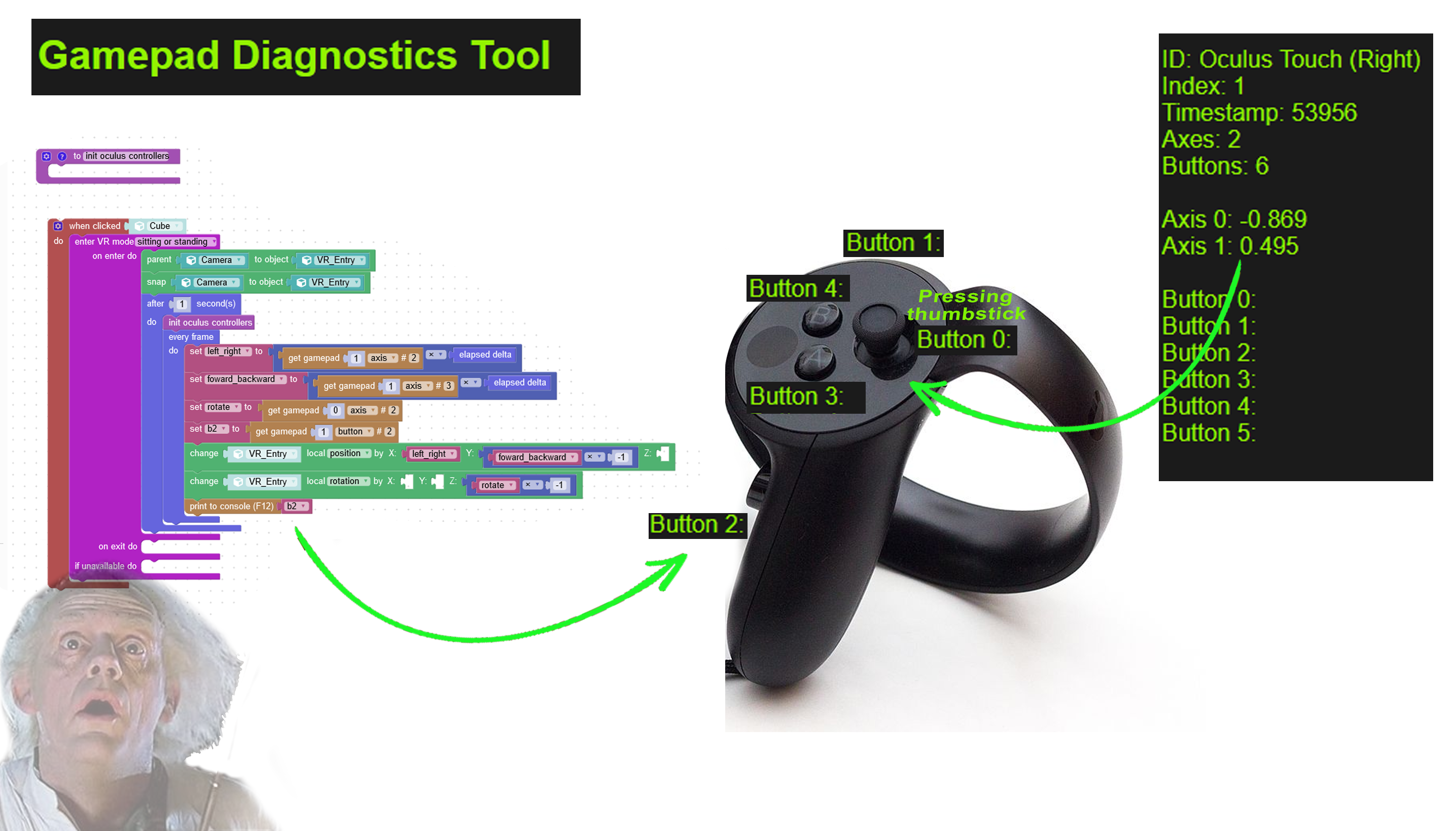

    My Oculus is connected via a USB C cable and im running the Link.
    I can read both controllers axis 1 and 2, see the attached diagram.
    What I cannot do is read any of the buttons. I cant read anything in the Squeeze Event also as you saw in the previous screen shots.
    The Robot demo has nothing in terms of navigation or buttons, its all on hover actions. Its done differently. I would like to be able to pick objects up and move them around. There is a demo but I cannot get it to work as the Squeeze start function will just not work for me. I cant get this work at all: https://www.soft8soft.com/verge3d-3-1-for-blender-released/
    Thanks for any help. :good:

    Just wanted to update the diagram.

    Great Scott! Love the updated diagram..

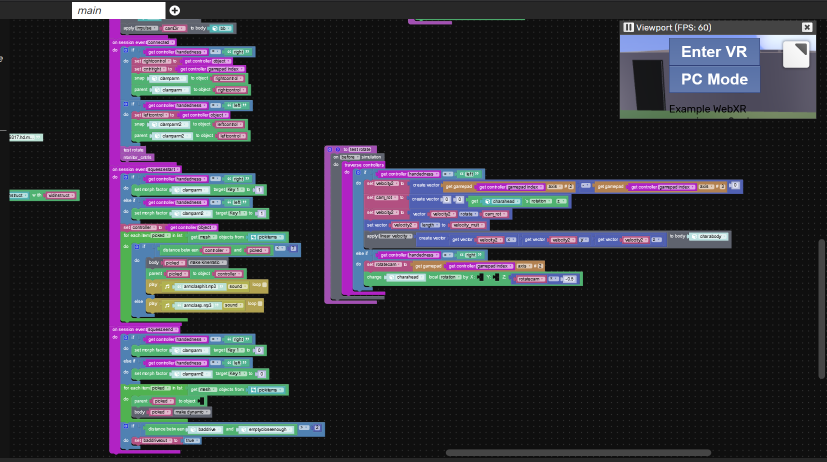

    I’ve been meaning to collaborate a bit with Yuri and ask him to create a template puzzle (that can ship with future verge releases) which gives you drag and drop access to a complete set of physics based oculus controls (assuming your scene has a character body & head objects setup) including setup for default oculus “hands” or slots to add custom controllers (like my golden lobster pincers in my demo video– which articulate on squeezeevents (uses a simple shape key) and if there is an object within distance X, it changes the picked object from dynamic to kinematic, then snaps and parents the object to controller hand. On squeeze release, object gets converted back to a dynamic object and unparented, so you can throw it. Easy cheezy.
    I actually will attach a snapshot of some puzzles – please note I don’t think the ‘test rotate’ procedure is correct. I believe the first IF statement was my attempt to use physics to drive rotation that I never got working, but the ELSE IF, where I directly rotate the camera rig from controller input did work.

    Thank you so much for that awesome response. I will spend all of next week on it. What I do need and just cant get working is mapping the buttons like as in the diagram I showed, there my biggest problem is not being able to detect the SQUEEZE START event. Ill keep trying.
    One more observation, regarding using physics to pass vectors to the camera, I do this in Unreal where its called using a Spring Arm, allowing to swing behind the first-person. Its nice but for use over 5 minutes it tends to cause motion sickness. We found that not having this, IE just having a fixed camera is much better for motion sickness. I use it in a given moment where I want to highlight what ever is going on.
    So to summarize Im stuck on detecting the trigger squeeze :)
    Regards and thank you!
