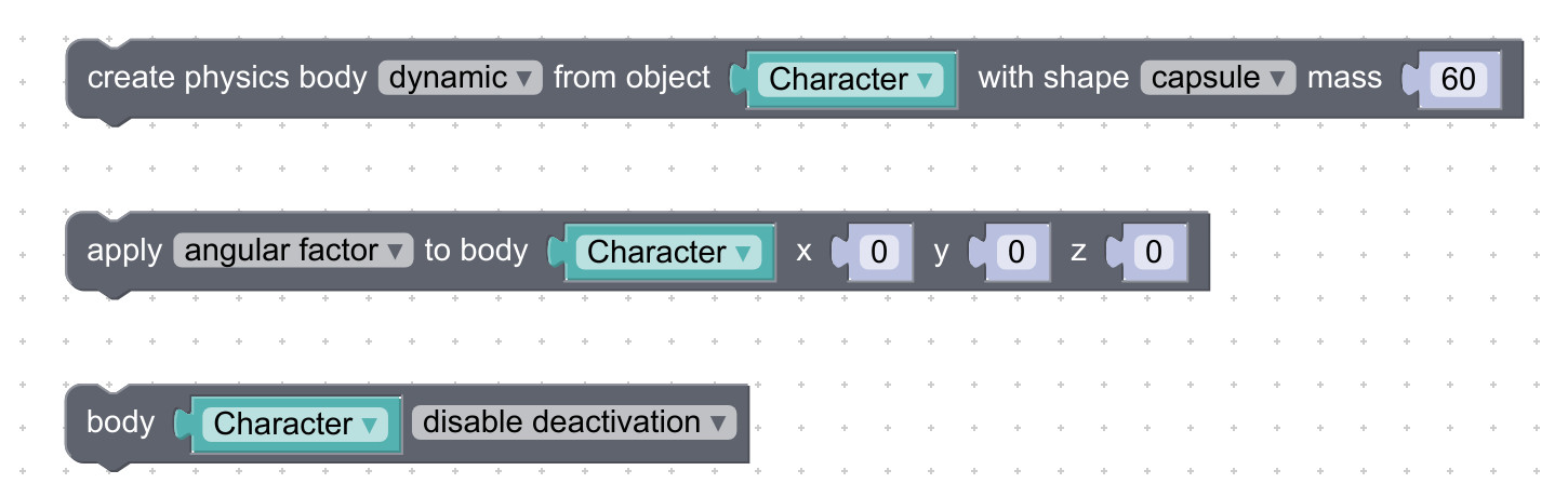

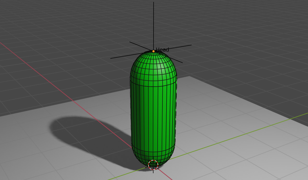

Create a capsule-shaped object which represents your character. Tune its height and width to look more realistic. Make sure you set the center of your object correctly.
In puzzles, assign dynamic capsule-shaped body to the character and disable its rotational degrees of freedom. This way, you allow your character to move but not rotate. Also, apply disable deactivation to your capsule.
Since character needs a floor (+walls) or ground to walk on, create such bodies using the corresponding create physics body puzzles.

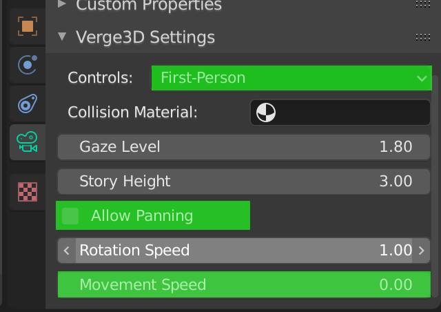

The next step is configuring the camera. The camera won't have any physics assigned since we only need it to be our "eyes." Set the First-Person controls to it but don't assign any collision material (we'll be using full-featured collision detection provided by the physics engine, not basic floor/walls simulation). Also, uncheck the Allow Panning and set Movement Speed value to zero:

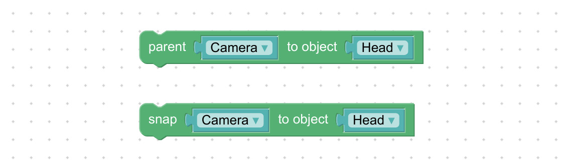

Now we need to attach your camera to the character's "head." There is no need to create a model for the head, add an empty object called "Head" to the scene, and parent it to the upper part of the capsule model. This way the "head" moves with the character.
By using the additional "Head" object you can attach/detach the camera to/from the character in runtime. To attach the camera use the parent and snap to object puzzles:
To detach the camera, use the parent puzzle with empty to object field.

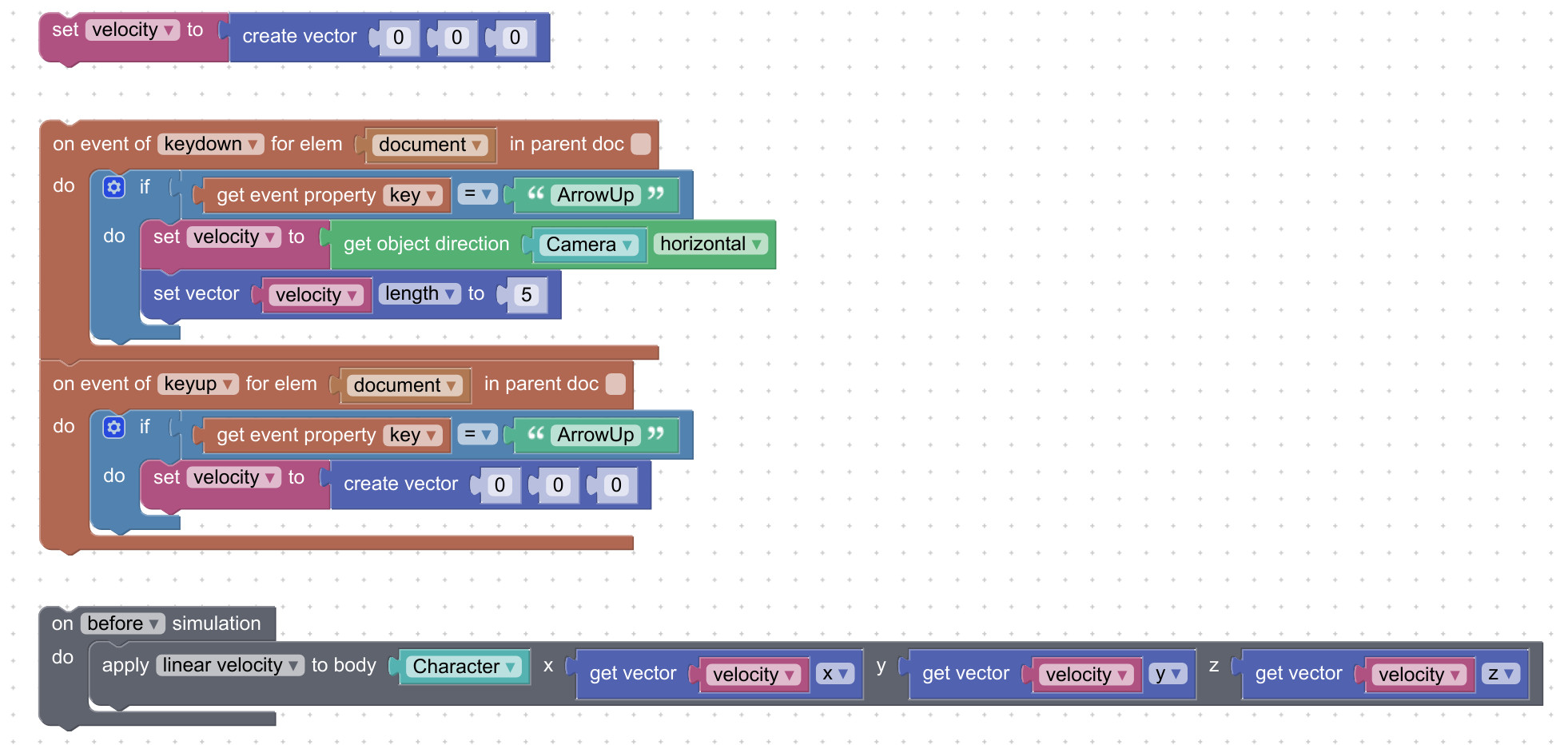

Character created! Now it's time to make it move in your scene. In the most basic case, we need to move forward when the user press the up-arrow key. To do so, apply linear velocity vector to your character, which is calculated from the horizontal camera direction. To make your simulations robust you should always apply vectors using the on simulation tick puzzle.
