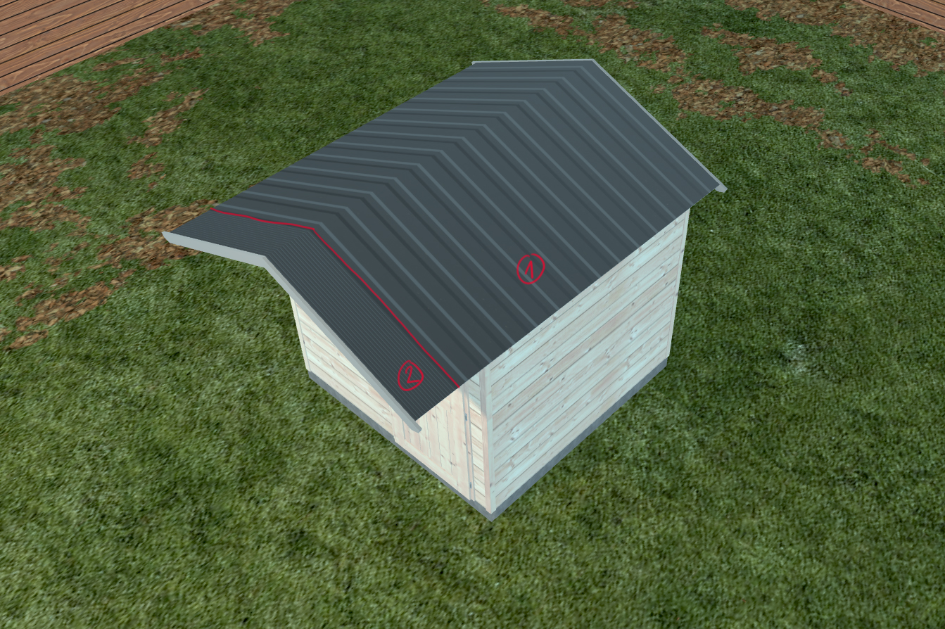

    I am almost ready with my project and it’s working almost perfectly, except for one thing.
    As you can see in the attached image, I have a roof with a simple texture. I use box mapping because of the shape keys. I cut the front part of the roof as you can see in red since I already have 6 shape keys and need more, so I have solved it into two objects and it’s working just something went wrong with the texture. I realized it’s happening when I delete some party of the original roof object.
    Is it possible to keep the original texture size or UV or whatever when I modify the roof object? Somehow preserve as it was before I sliced.
    Thank you very much in advance!
    #50281
    peet
    I have noticed one thing.
    The “auto texture space” parameters are changing, probably because I sliced and deleted some parts of the original object. If I turn it off the “auto texture space” in blender is working but if I check it with “sneak peek” it’s shown wrongly. Just like before I turned off the auto texture space. :scratch:
    #50285
    Auto texture space not supported.
    #50288
    peet
    Hi Mikhail!
    Thank you for the information!
    Luckily it is solved. I was counting the basis as a shape key, so I could manage to add another one. My fault. :good:
