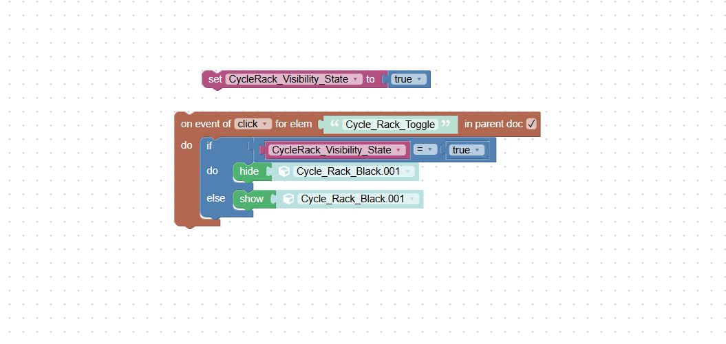

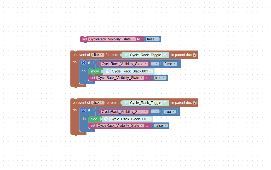

    May I know what’s wrong with this puzzle for a simple visibility toggle button setup?

    You only want one On EVent click and put an if then else puzzle in it if true then show else hide…rather than two different event click puzzles with different logic.
    The way you have it with two event click puzzles will result in only the top event puzzle firing.

    muthu3dtech
    Thanks for your help. But I already tried that, but I m not getting the toggle functionality. Can you please point out what is error in this puzzle setup?

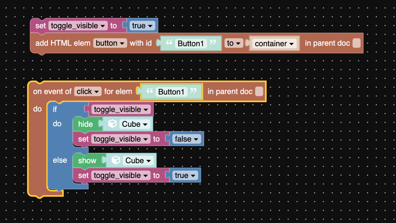

    #81855
    you are close..you forgot to include the changing of the variable from true to false in your if statement.
    See attached

    muthu3dtech
    Thanks a lot. It is working perfectly now.
