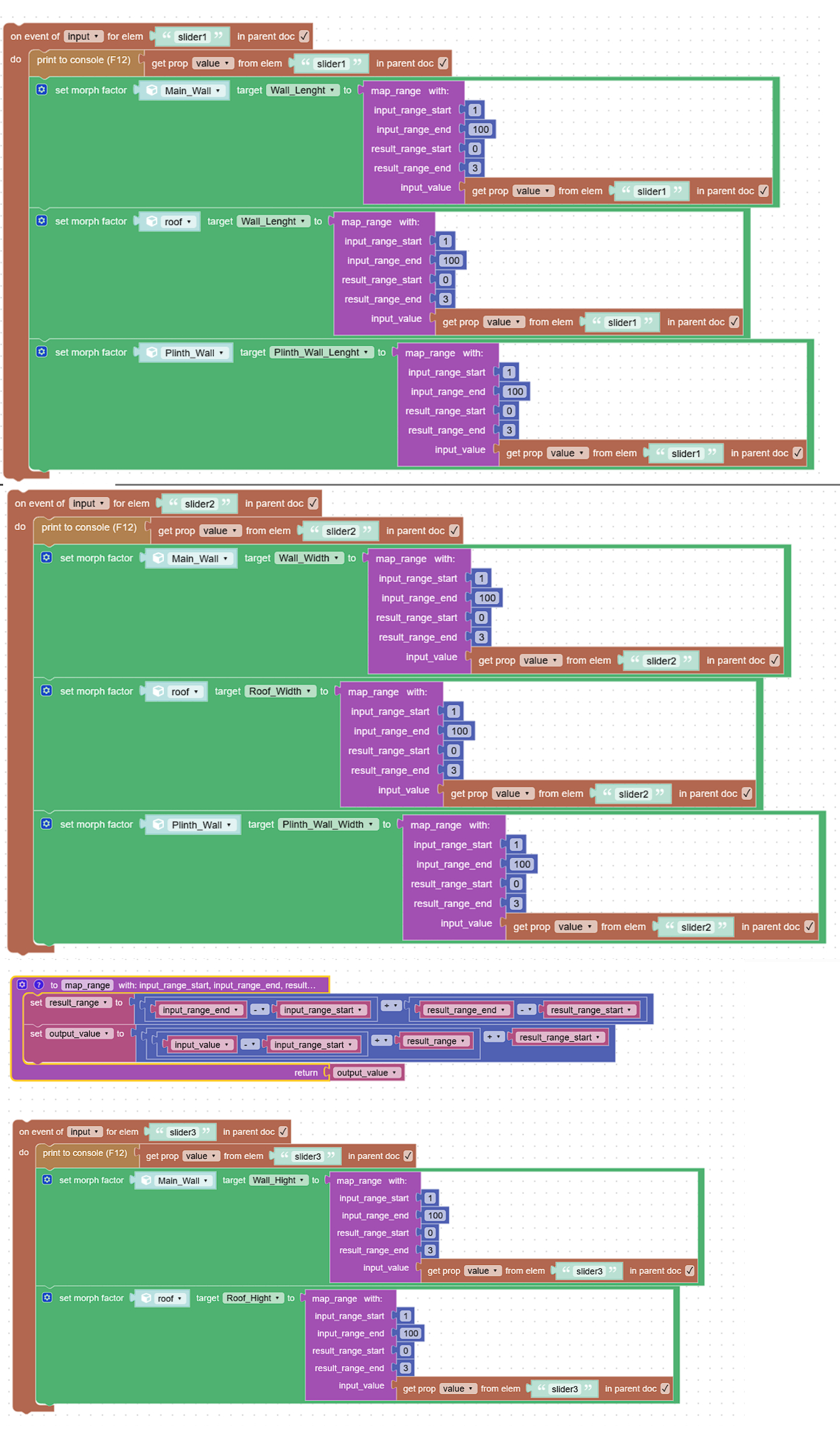

    #66865
    mashud008
    here is the verge 3D 4.4.0 morphing factor image
    Mashud Rana
    3D Modeller | Rendering & Interactive Expert
    www.rana3d.com
    #66866
    Check everything twice and do not make such mistakes
    Nothing has been changed in 4.4.0 with morphing. The problem is either in your logic or in your changed .blend file.

    #66870
    Works fine with 4.4.0 https://v3d.net/ntu
    The problem is in your .blend file. Re-create shape keys properly.
