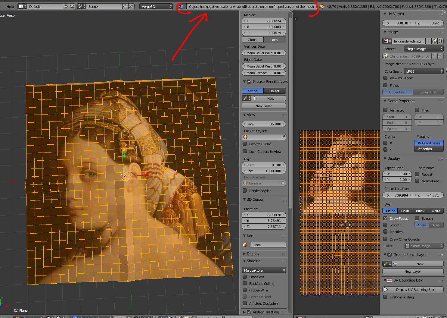

    The image texture don’t respect the sens of the axe x. The picture is reverse. Look at the Odalisque in my example in Blender.
    #7405
    I tried to unwrap it and what Blender says.
    Just apply scale before unwrap and all will be ok.
