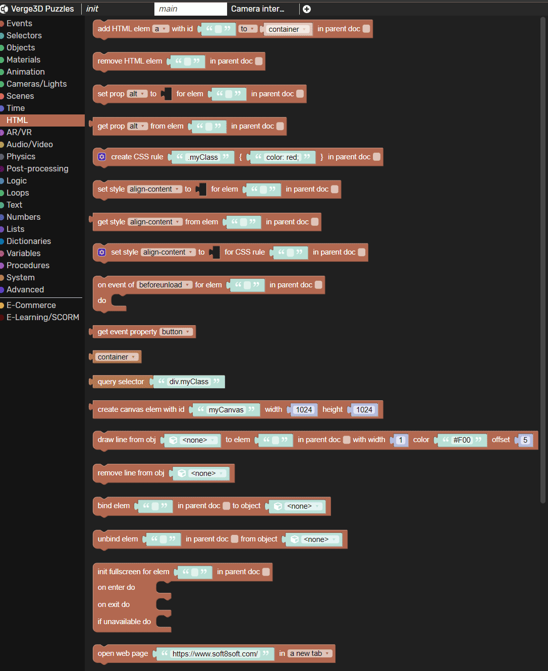

    Hi there,
    Just a quick question, i can’t see “set attr” under HTML tab. I’m using Verge3D 4.2, any suggestions?
    #59178
    set prop
    #59179
    Marcin
    Thnaks :good:
