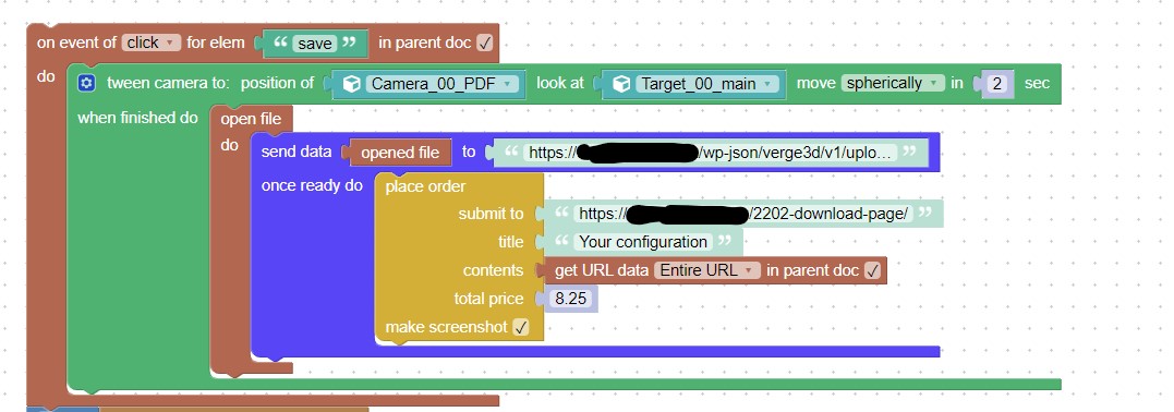

    Hi there! I’m having big trouble with the “send data” puzzle that I urgently need to solve. I need to send a file to the web storage, and I tried to recreate the puzzles from the “Custom Image” application. Yet it didn’t work. When I try to send the opened file (JPG or PNG) like in the screenshot below, nothing saves in the given location (the application is uploaded to the website via the Verge plugin of course). And moreover, “once ready do” is not executed. No order is submitted to the plugin. Any ideas about what is happening here?

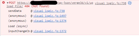

    Hi, anyone can take a look a this situation? The problem still exists. In the console, I get the 404 (Not Found) Error like in the screenshot below.

    Ok, never mind, I found the solution! I am not a programmer, so it was kind of obvious to me, that when we use a certain path, it should in fact EXIST in the website. So I manually created wp-json folder. And apparently, that was causing the solution. When I removed the wp-json folder with its content, the “send data” puzzle worked and saved the required files in wp-content/uploads/verge3d/files. :yahoo:
