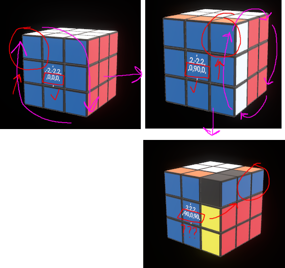

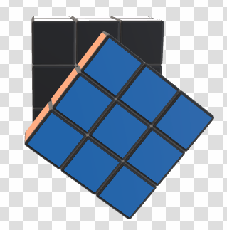

    Hi, so I’m trying to make a Rubix Cube for my school project and while I was trying to just do rotation I realized that any rotation I did would just rotate around the first cube of the Rubix Cube which I don’t want. How can I make it so that they get rotated around the middle cube? Demonstration of the current unwanted rotation is located in the attachments.
    #74580
    giegel
    Video attachment doesn’t work so I’ll attach a screenshot instead oops

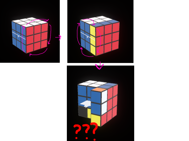

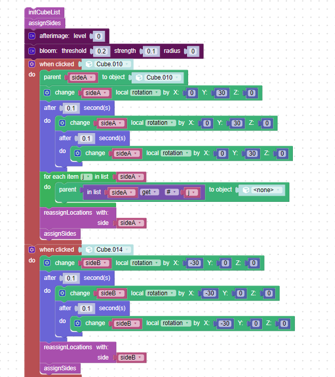

    Subject sort of changed from the original post but I’m not creating another one cause that’d be kinda useless and it’s for the same project anyways. But like. Why is this (attachment 2) happening??? In attachment 1 you can see I never even tried to rotate the Z axis and yet my X-rotation just completely vanished and turned into Z-rotation after rotating on the Y-axis. The reassignLocations just changes the locations of the cubes and assignSides function just assigns all the cubes to their corrosponding sides, so those have nothing to do with rotation, so that couldn’t be it either. Very strange, I hope there’s an answer that will allow me to continue without debugging for another 5 hours
    #74642
    giegel
    Oh and the parent sidea to cube10 block didnt change the result whatsoever i just kinda forgot to get rid of it before taking the screenshot oops
    #74649
    No need to rotate all cubes Side A after parenting to Cube.010. You need to rotate only Cube.010 and all its children will also be rotated. In the second puzzle you didn’t parent Side B to Cube.014. There are six cube that will never change position (central cubes). Rotate only those six cubes with other cubes parented to them beforehand.

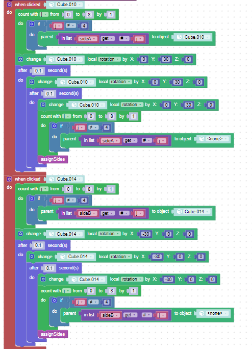

    I’m somehow getting an even stranger result by doing this (the if j =/ 4 is to make sure cube10 doesnt parent to itself)
    Seeing as I’m getting quite desperate now here’s the google drive for the entire project so you can see all of the puzzles yourself in case the brief puzzle attachment isnt enough (I’ve only made the sideA and sideB rotations work properly seeing as that’s enough to test stuff)

    #74660
