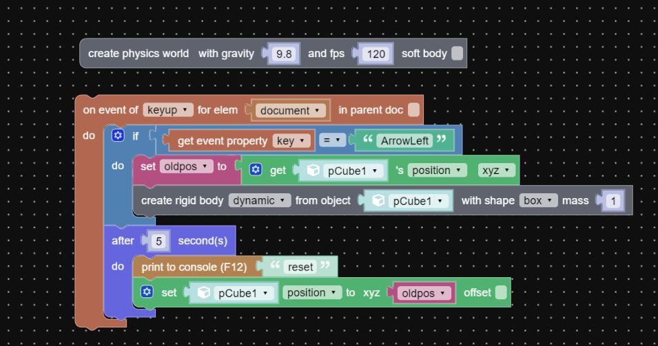

    Im playing around with physics and would like to reset the position of my object after applying physics to it, to get to the start position again before physics changed the position.
    here’s is how I tried it
    puzzle
    #56581
    remove physics body from object before changing its position.
