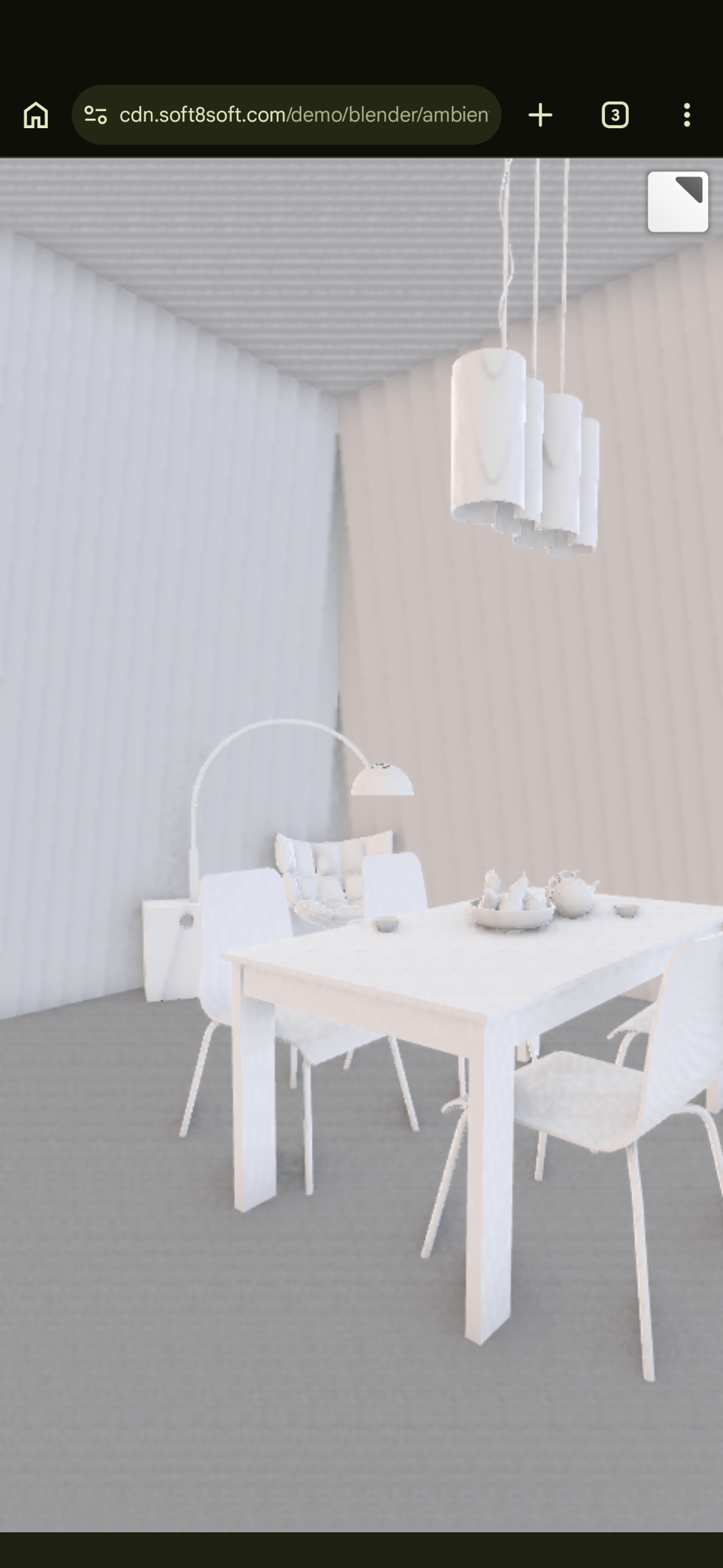

    I’m experiencing an issue with visible banding artifacts whenever Ambient Occlusion (AO) is enabled in my app. The problem only appears on Android devices; I don’t see it on desktop.
    I’m using Verge3D 4.12 and Blender 5.0.
    Does anyone know what might be causing this issue on Android devices? Is there a way to eliminate or reduce the banding while keeping Ambient Occlusion enabled?
    Any help or suggestions would be greatly appreciated.

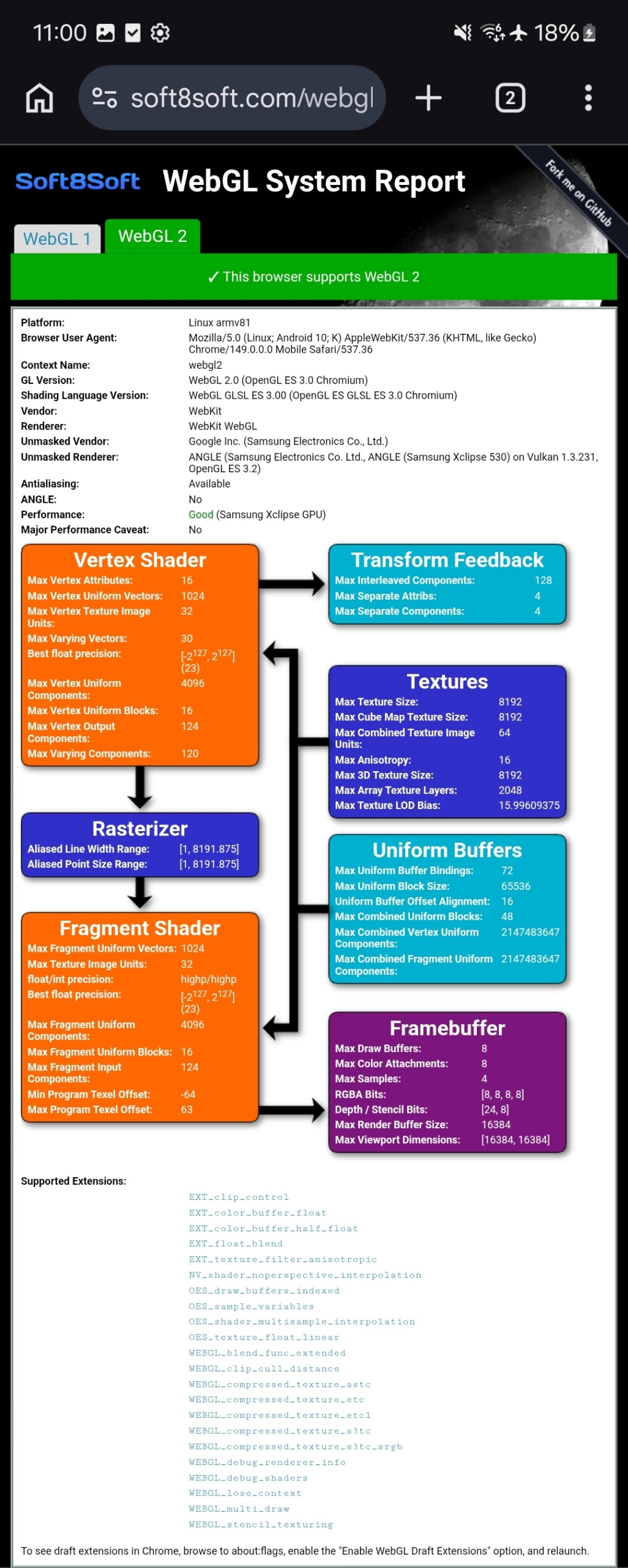

    #87463
    What kind of Android device you use? Also please share the content of webgl report page, especially Unmasked Vendor/Unmasked Renderer lines.
    #87465
    martenmonoz
    A Google Pixel 6 Pro and a NothingPhone 2.
    edit: (UV:Google.Inc UR Angle (ARM for pixel and Qualcomm for NothingPhone)

    Thank you for the info, we’ll take a look. BTW can the issue be reproduced when running our stock Ambient Occlusion demo?
    #87472
    martenmonoz
    Yes the standard demo has the same problem.

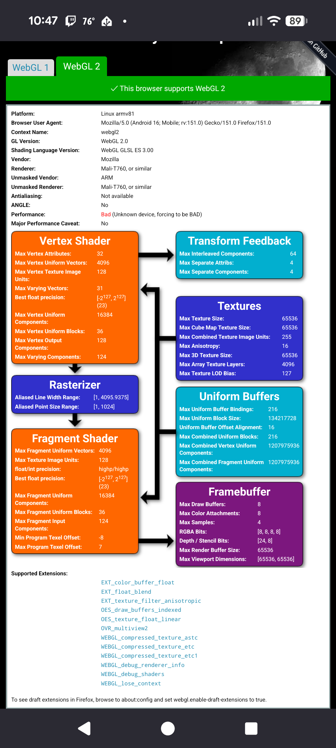

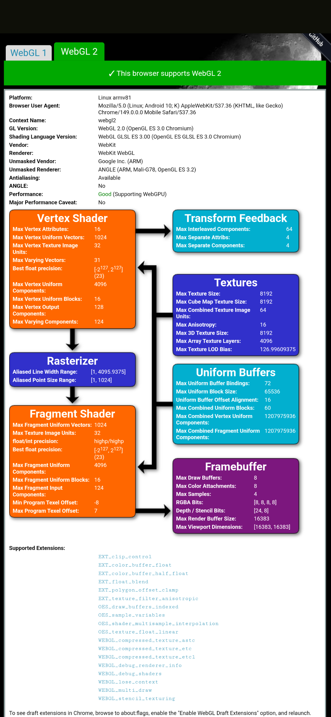

    #87477
    backpackvacuum
    I coincidentally came here to ask about the same issue.
    I actually do have an android device that doesn’t have the banding issues. It’s a Samsung Galaxy A55. Attached is the webgl report for it.
    I’ve tested on a Pixel 8 and an S24, and both of those have the banding issue.
    #87490
    Thank you for the screenshots. It helps a lot! I have good news too. We’ve finally figured it out and are going to fix this issue in the upcoming Verge3D update. Stay tuned!

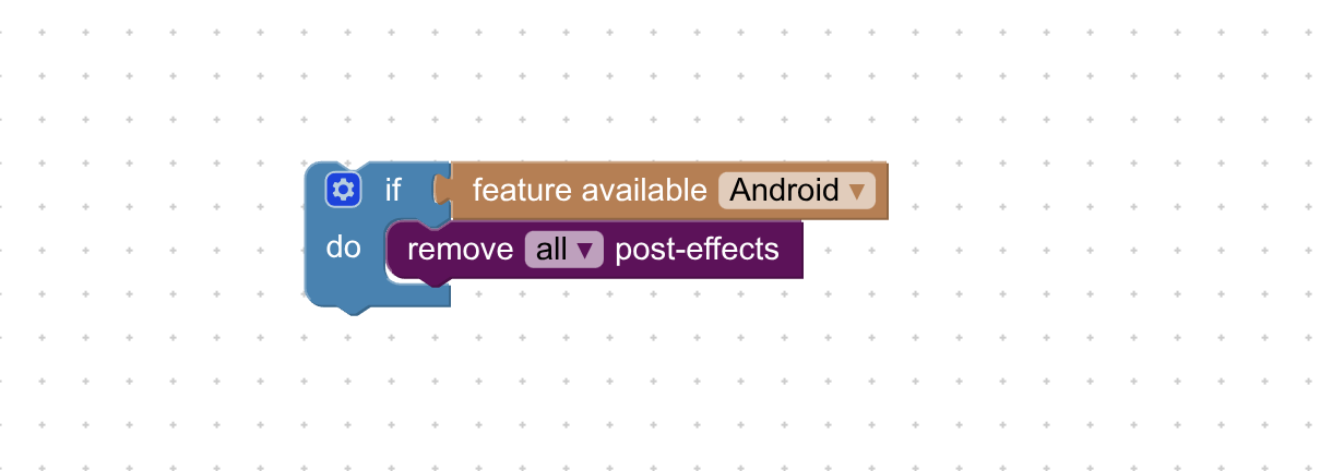

    #87495
    Verge3D 4.13 pre2 can be expected later this month. As a temporary workaround you can disable postprocessing altogether on Android devices, e.g. by using the snippet below:
    #87500
