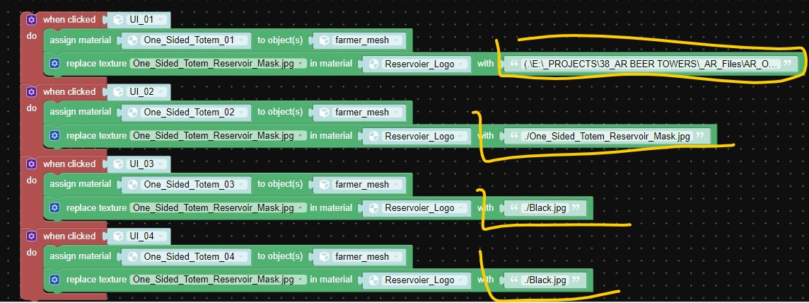

    Hey everyone
    I can’t figure out what to input in the URL there when changing a texture.
    Any tips?
    Tried the exact url on my folder structure, tried the default { url(‘./path goes here’)
    but still no luck
    #55584
    ./path/to/your/image.png or path/to/your/image.png
    The path is relative and begins in the app folder.
    #55593
    Hi, see instructions on specifying paths here.
    #55601
    andrei pek
    Thank you Kdv, Thank you Alexander,
    It worked. I was adding the (./) in the text there and it didn’t get the name right I’m guessing, having just the file name and keeping the file in the root folder of the app works.
