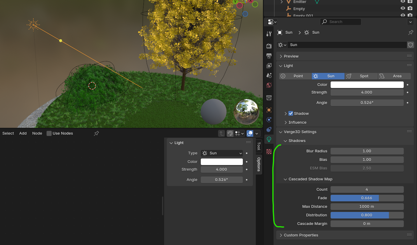

    – There is three “levels” of shadows applied depending on zoom level. I wonder how we can control this. You will clearly see how there is a shadow line traversing over the grass when zooming in and out. Preferably this could be mitigated.

    Also I forgot to mention the cascade shadows – you can set the blur between cascades (and much more) in Verge3D segment under Sun settings!
