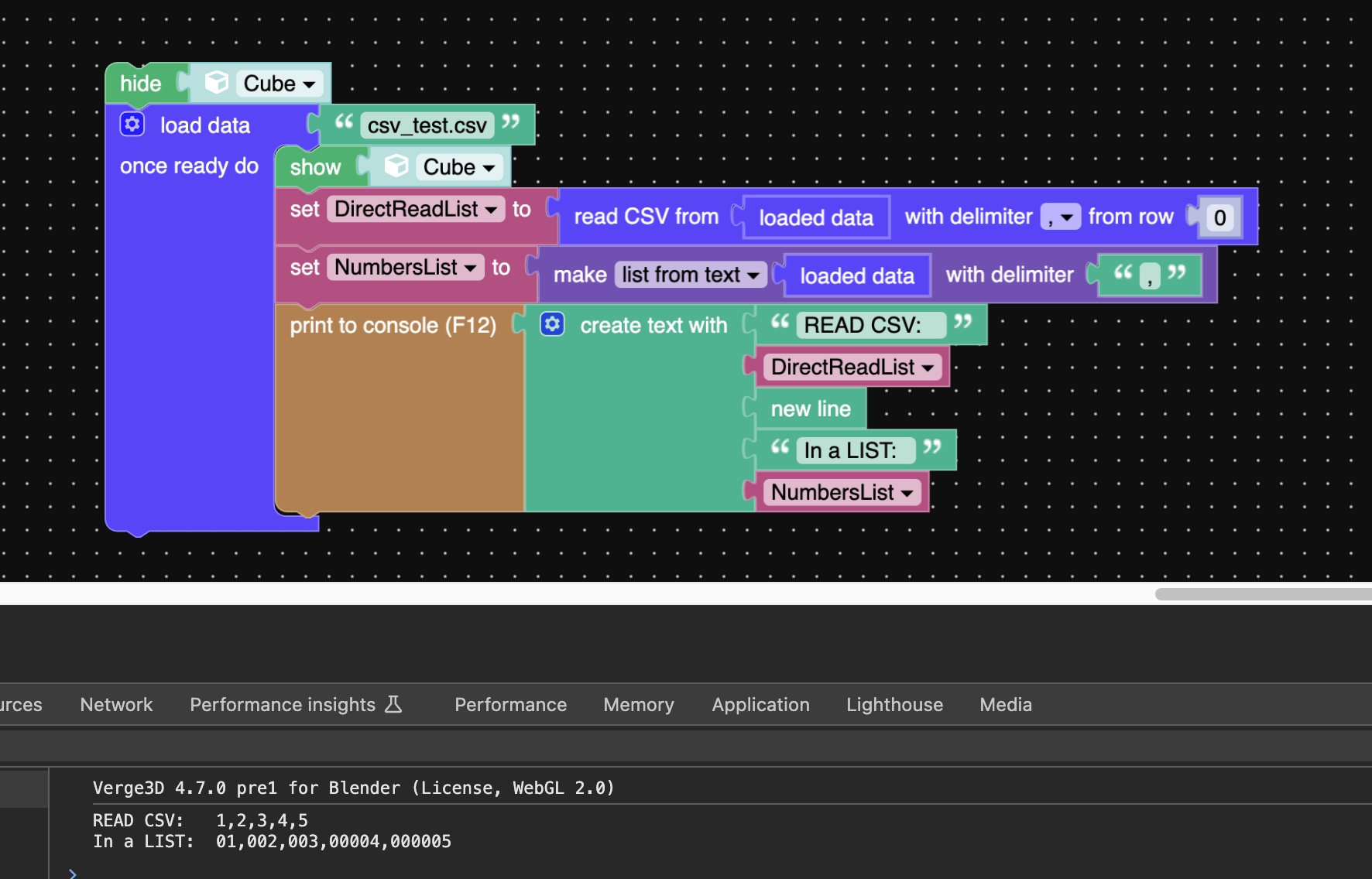

    You can get around this by using a list puzzle and “load data” directly into the list. This will keep the leading zeros.
    See puzzles and console log attached.

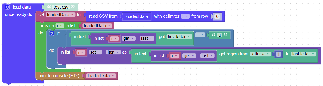

    change your formula to =TEXT(A2;"a000000") and after reading values from .csv just remove “a” from all values.

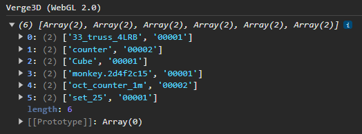

    33_truss_4LRB;a00001
    counter;a00002
    Cube;a00001
    monkey.2d4f2c15;a00001
    oct_counter_1m;a00002
    set_25;a00001

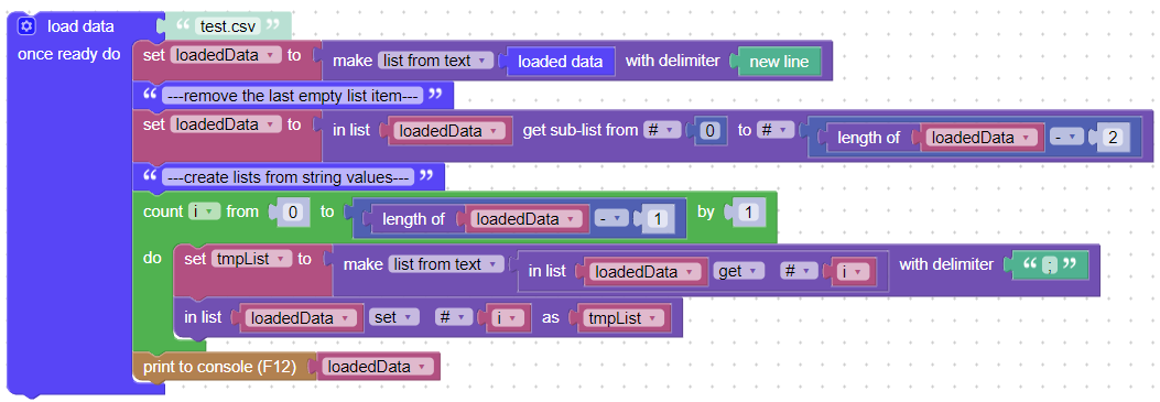

    but if needed, here’s a replacement for the “read CSV” puzzle: no numbers, string values only.
