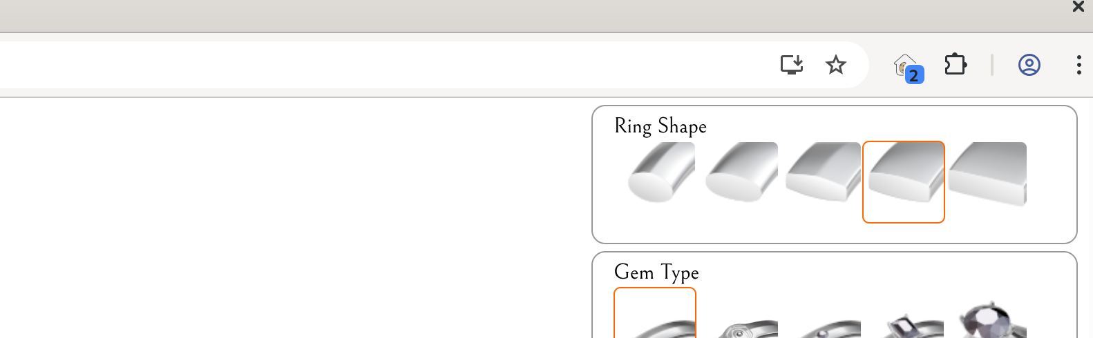

    PWA applications should display the installation button in Chrome:
    PWA installation button
    Regarding web server (local or online), it should not be required once the application caches all its assets on the first run.
